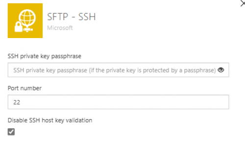

I have flows that look at the Hosted Files folder and if a file is moved or created it will copy the file into Sharepoint for me. This is used mostly for Queue.
I haven't gotten this error in a long time but I can't modify the flow now it keeps saying the FTP connection has a bad gateway error. I have copied the password into my FTP connection a few times in the last few days so I know it's not a password issue.

@Carol Grant - When you update the connection details make sure you check the box to “Disable SSH host key validation”.
