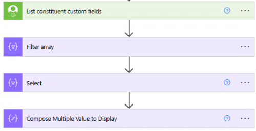

You can use an array variable to store the “multiple” value of Interest Area, but then you will need to make sure you use the join() expression to join the multiple values into ONE string to display back on the adaptive card.You do not need to use variable at all if use some data actions.
- list constituent custom fields
- filter array of custom fields by category
- this give you an array of custom fields object (i.e. object that contains subproperies such as value, ID, category, etc)
- SELECT action to select ONLY the “value” property from the array of object
- use join() expression on the SELECT body dynamic content to join the multple values with a delimitor:
no need for apply to each loop make sure you select the value dynamic content that has description “The set of items included in the response…..” use “Body” of Filter array dynamic content join(body('Select'), '; ') 1 -

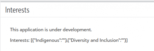

This is amazing, thank you! I think I'm getting a better understanding of how these pieces fit together too.This works, but the result I get contains a lot of extra characters:
I've tried a few things but can't seem to avoid this. Am I right in thinking it's literally printing the array?

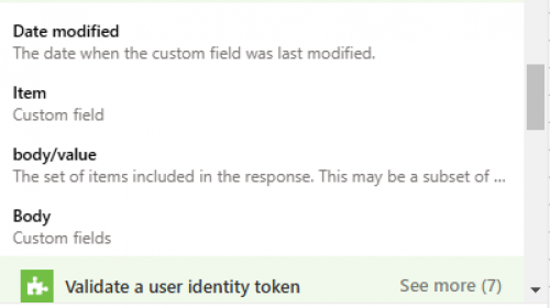

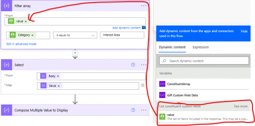

I think this is related to the Filter Array step; your instructions note to use the Value with the description “The set of items included in the response…” I don't have (exactly) this option; mine is body/value (the Value option adds the For Each loop because it's iterating through the list). Is the problem that it's picking up on more than I need?0 -

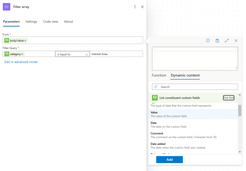

Here is the edit window for the Filter Array action:
And this is the value in the dynamic content menu:
The Value (you see in the first image) doesn't have the description “the set of items…” and when I add it, it automaticalyl goes into a For Each loop. I don't think body/value is right either, but that's the only other option.

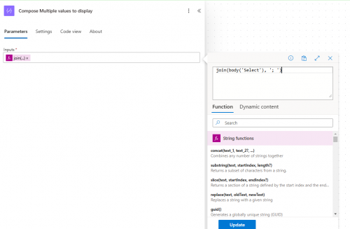

As for the join expression, I copied what you noted and entered it as a function:
This doesn't appear to work at all because the delimiter isn't showing in the result.

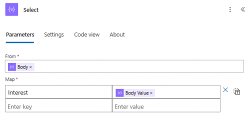

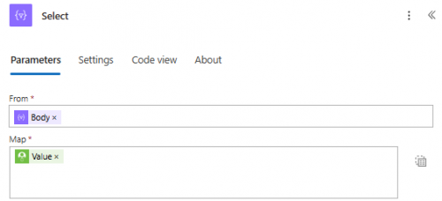

I also noticed that the extra :"" I see in the result is becuse of the key/value pair in the Select action. I had the value in the key field initially. Your image shows only the map, but if I leave the key blank I get these characters.
As for the run history, there have been no errors – everything executes as expected. But I wonder if there's an error in my Select action – here's the Output:
[ { "Interest": "Indigenous" }, { "Interest": "Diversity and Inclusion" } ]
…which is exactly what's showing in the card. It's like the flow is skipping the Compose action (with the join expression) entierly.

You are using the “new designer/editor" so it looks different.Filter array From needs to be the dynamic content that has the description that say “The set of items included in the response…” NOT the one that has description that say “The value of the custom field”. so from your 2nd screenshot, the one that is “body/value” is good.
Your join() expression is good, but your Select action is likely wrong, you didn't have screenshot of it.
I am going to suspect this is what you have:
which is making an array of object with 1 property:
[ { "Interest": "Indigenous" }, { "Interest": "Diversity and Inclusion" } ]Instead:

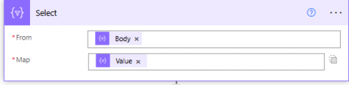

this is to make an array of string, not array of object:
[“Indigenous”,"Diversity and Inclusion"]2 -
@Alex Wong Thanks so much, this is perfect!
I did have the Select action you guessed, and fixed that. The card still wasn't populating as I expected – but this turned out to be an error in the Compose action that creates the adaptive card (I had the wrong output). I fixed that, and except for some minor formatting changes, this is now working as expected. I'm very excited; this opens a lot of potential for us.
