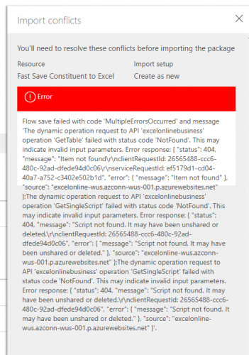

@Alex Wong Hi Alex, I am trying the fast save template but I keep getting this error message during import.
Configuration details:
- Download Column Number to Letter.xlsx and save it in SharePoint somewhere
- OPTIONAL: Download CommonFormat.zip extract the CommonFormat.osts file and save it to your OneDrive > Documents > Office Scripts folder
- There is an action at the last step of the process to do a nice common format (autofit columns, autofit rows, freeze header row, make the data range a table and give it a table name of “GiftTable” (which you can change in editing the script, not in scope for this post)
the OPTIONAL i guess is not optional with the flow saved the way it is. you are missing the script that does the common format of the excel table.
