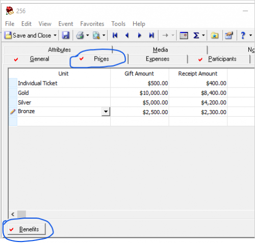

Hi, @Jolynn Uyehara. @Karen Diener's question is the starting question. Are your online registrations coming in thru OLX, NetC, or NXT? If they are, then the event fees are set up in the event creation step.
This screenshot from db is for an event we have. Ticket price: $500/person. Charitable portion: $400. This one doesn't have table option but fee and benefit easily computed. For each ‘unit’ of the event, enter unit name and then click ‘benefits’ at the bottom to enter the two $ figures.
Note, it is functioning as designed but it will list full gift amount on person's record and in all giving reports, unless it's one where you can use receipt amount. If you only want the ‘receipt’ amount on donor records, it's manual.
