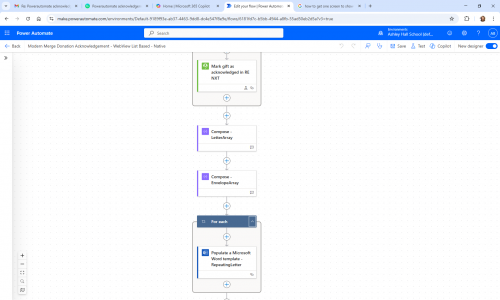

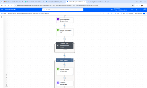

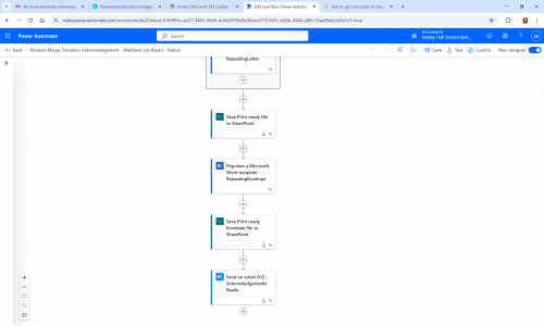

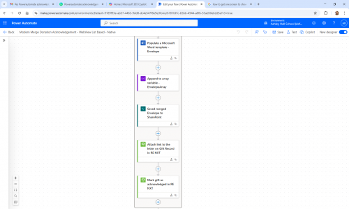

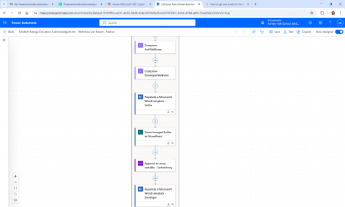

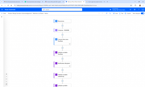

Populate a Microsoft Word template does not create a file in SharePoint, the “content” of this action can then be used in a “create file” action, be it sharepoint, onedrive, google drive, etc. Or it can directly be used without saving anywhere directly in attachment of an email.If your flow is saving file to sharepoint, then the loop (apply to each gift) that populate the word document, and then another action to “create sharepoint file" would only create one word document per gift. There would not be a “master merged” word document that contains all the gift's acknowledgement letter, unless your flow does more to create such “master merged” word doc. (by the way doc file is not good, the file should be in docx format, without going into too much details, your IT policy may prevent opening doc file for security reasons.
Going back to what I relied to Carla previously, please provide screenshots of your flow in edit mode and run history mode to help determine what may have went wrong.
@Alex Wong Sorry, it is in the docx format, not doc.
@Ann Barnett
very blurry screenshot due to Community way of processing image.. sigh.. but able to make some info out of it.Next time don't paste image too “wide”, you can just screnshot the “center” area of the action only, will not be as blurry
So from what I can tell, the actions are (in a nutshell ignoring compose and variable):
- trigger (recurrance)
- gift list
- condition on if any gift
- i can't see the yes/no, but considering your apply to each gift is “outside” of the condition, I'm assuming your condition if no gift has an action to “Terminate” the flow
- apply to each gift
- get donor info
- populate word letter
- create letter file
- populate word envelope
- create envelope file
- some gift action - can't tell
- mark gift as acknowledged
- apply to each (no idea what this is)
- populate word document - blurry, but suggest this is a populate word document with repeat control
- save another file (i don't know what this is)
- populate word document again - looks to be repeat control for envelope
- save another file (assuming this is the repeat control for envelope)
- send email
The red above looks to be the error. I am assuming you have another word template that has the repeat control for intaking an “array” that will create ONE word document for all acknowledgement. If that is true, then the apply to each in red is the problem, there shoulnd't be an apply to each.
