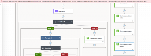

The second issue is with participant options. Again I have an MS form field that should go into a participant option. I have tried both using the response from MS form directly and doing a Compose action to ensure it is type of text and using that output and no matter what I get this error when trying to save:
Flow save failed with code 'OpenApiOperationParameterValidationFailed' and message 'Input parameter 'body' validation failed in workflow operation 'Create_a_participant_option': The API operation 'CreateParticipantOption' is missing required property 'body/option_value'.'.

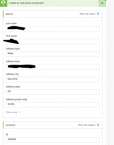

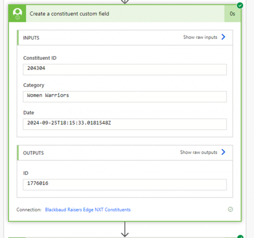

please send screenshot of these actions in edit mode and a run history:- the action that gave you the constituent system id that is used in the create constituent custom field action
- create constituent custom field
- the action that gave you the participant system record id that is used in the create participant option action
- create participant option action

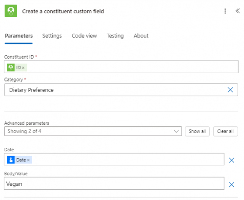

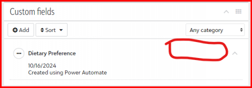

- Ironically, I was testing something this morning for a BB customer and I ended up with the same exact issue. In the screenshot below, I am using the Dietary Preference field. From this menu, one of the options in the drop down is “Vegan" which I am trying to add via the Body/Value field. The flow runs successfully and creates the custom field but does not add the value “Vegan”.
@Alex Wong

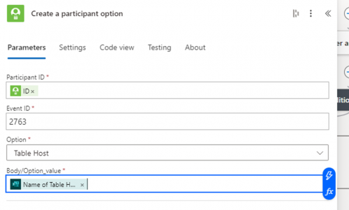

Thanks, Alex! I'll start with the participant option issue. I've tried using the MS field and also a compose output of that field.0 -

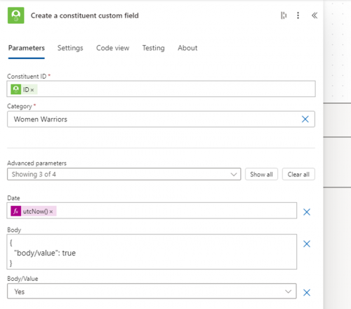

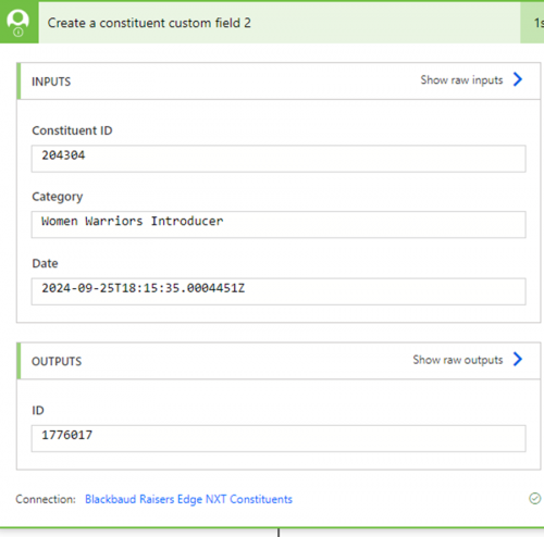

Now the custom field problem:
When I look at my run history and/or edit in the old view, it doesn't show the body/value field that I mapped. It does show in the new view of the editor, but all body/value fields I map are coming over blank.0 -
@Jeff Lallo
Your issue is resolved when you use old designer, so go to the old designer and delete the values that is there, and make sure to select from the selection.the new designer does not allow “selection” in the flow, you need to type it in
old designer, when it is a selection, the value is likely not the actual “english” text but the tableentries id when it is a table.

@Alex Wong - thanks for the input. Works as expected in Old Designer. This has taught me to flip from Old to New (or New to Old) when experiencing unexpected oddities.
@Jeff Lallo
I don't recommend that you switch new and old back and forth. For example, the action that you do for creating constituent custom field, after editing and saving in old designer and working, if you were to edit the same flow in new designer later on, you might make this action not work again.Stick with old designer until you know what is not working, is fully working in new designer.
