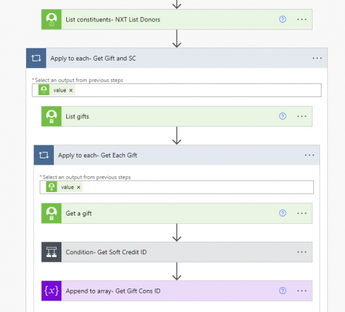

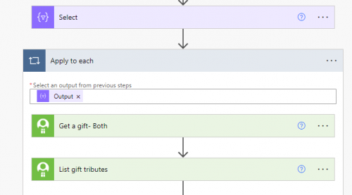

I'm trying to get a flow working for donors who have given $2,500k and above including soft credits. I've been trying many different things in the past few weeks and decided to use a NXT Constituent List. The issue is getting the gifts to list out correctly. Also to get the donors who give through Fidelity Charitable (DAF) and sum up the soft credit donors for $2.5k and up.
  1. I'm using List Constituents to get the people but then I need to get their gifts.
  2. Then I have List Gifts with the ConsID limited by the IDs in the NXT List. Then Get a Gift to have an array to grab the Soft Credit ID and Gift ID then another array to get any other donors that has ConsID and GiftID.
  3. I have a union that combines these 2 arrays. Which I wonder about because it removes duplicates. (?)
5eb62d0b3523d4ee2fd46ed3958a576a-huge-im
4. Then I'm putting the combined array back through to get the gifts for both soft credit and regular gifts using a Select. This seems redundant but I don't know how else to connect the soft credit gift and the other gifts. The problem with this is it pulls all of the Fidelity gifts in for the week not just the ones that belong to the $2,500 soft credit donors. There is a disconnect when I do it this way.
e685884177cac51e55ab87f28ef1eb0f-huge-im
Does anyone else have any ideas on how to accomplish this? Besides creating my own database in Azure.

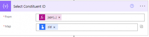

    • Run the query using Query API and use JSON output option.
    • Use “Select” to select only the constituent id to be used in a filter (one of) operator.
    • do a adhoc gift query with filter being constituent id is one of the constituent id from the select OR soft credit recipeitn id is one of the constituent id
      • what I don't know is if “one of” has the same limit as in db view query (500 is limit per one of).
    • run query… get result.. then it is a simple matter of using filter array on constituent id and soft credit reciepient id

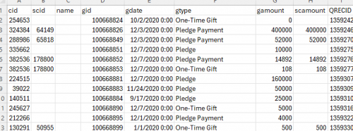

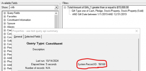

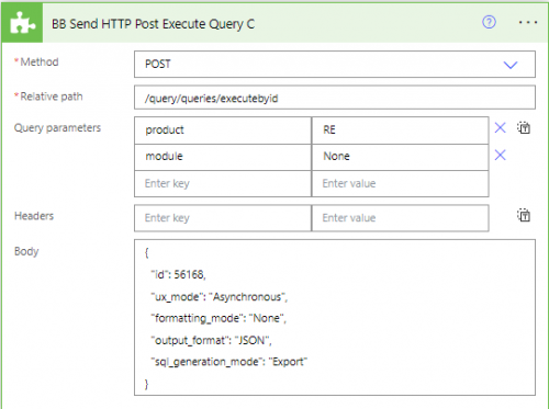

    So i just gave this theory a run…
    AND IT WORKS!
    60c62493a8d351a6f2984922ab43676a-huge-im
    Query ID: 56168
    3f72b983e0c8da9399dd1136ad9bb205-huge-im
    05a14aafc5f251d2a63c793d367add67-huge-im
    bc6c54e22376c58ee3a50cb636a105c0-huge-im
    json(base64ToString(body('HTTP_Get_Query_Result_C')?['$content']))
    a1f2b85155f4a3f92b85ae63072faae9-huge-im

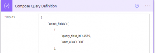

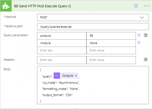

    Filter Field is using one of and the array of cid (constituent id) from the Select Constituent ID action. You can do more filter on gift type and gift date range if you want. (if you do, make sure the filter on constituent id and soft credit receipent id is in paranthesis as they are OR condition).
    (cid one-of OR scid one of) AND gift type one-of AND gift date between xxx and yyy
    314998a8285b609e0b6bf381a6eb4594-huge-im
    “query” property is using the Compose Query Definition and you can use JSON output if you want.
    95a23a147d96f8ae1c67ba800f50137b-huge-im
    After the download of the gift adhoc query, you can then use Filter array to condition on cid=someone_id OR scid=someone_id to get all gift direct or soft credit to someone_id.
    To loop through all the “constituent id” that is in your original constituent query of those that gave $X and up, you can loop through the output of Select Constituent ID which gives you an array of all the constituent id to work on, then use each constituent id in the Filter Array.
    25d45bdd379bdc1ef071176159ee59dc-huge-im
    json(base64ToString(body('HTTP_Get_Query_Result_G')?['$content']))

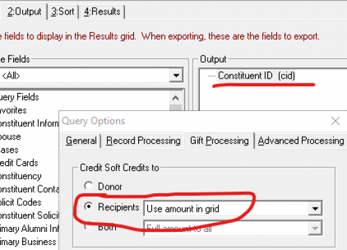

    which “soft credit option” you use on the constituent query affects if a constituent “qualifies” into your $2.5K+ so you need to think about your org's soft credit usage and how you normally report.
    The 2nd adhoc gift query you will use “soft credit option” to direct credit only, as you are going to output soft credit info. You can try this out on an actual db gift query first to see how it turns out for a constituent that has both direct credit gift and soft credit gift.
    Constituent IDSoft Credit Recipent IDGift IDGift AmountSoft Credit Amount
    111 8000000$5,000.00
    5551118000001$10,000.00$3,000.00
    5552228000001$10,000.00$4,000.00
    5553338000001$10,000.00$2,000.00
    5554448000001$10,000.00$1,000.00
    the gift query will look something like above. Assuming this is all the gifts there is, 111 and 222 qualifies as $2.5K+. Your constituent query will produce 111 and 222 only. (555 is the DAF)
    so when ad-hoc querying, you are only getting the first 3 rows. since you are looking at Constituent ID one-of 111, 222 OR Soft Credit Receipent ID one-of 111, 222. (by the way, if not apparent, you will be using the soft credit amount column if not blank. (use of expression will help here).

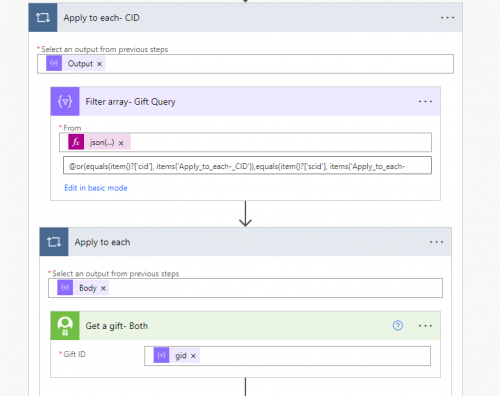

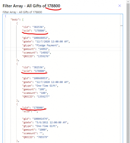

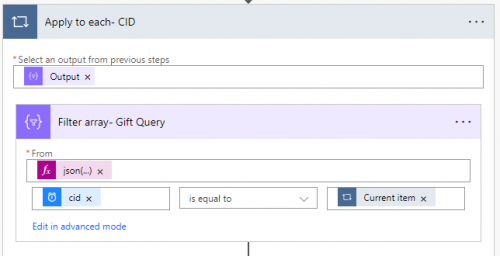

    Here's what you said before: To loop through all the “constituent id” that is in your original constituent query of those that gave $X and up, you can loop through the output of Select Constituent ID which gives you an array of all the constituent id to work on, then use each constituent id in the Filter Array.
    40b862263cd67a548655c7c649b20f1a-huge-im
    The Output under the loop is the Select Constituent ID.
    The json is my second ad hoc query results. Then I have item()?['cid'] in the first part and items('Applytoeach- CID') in the second part. Is that what I want?
    My filtered array appears blank for some and I'm not sure why yet. It is grouping the gifts by ConsID for others.
    Query 1- soft credit to both
    Query 2- adhoc query- I had soft credit to recipients.
  • Alex Wong
    Alex Wong Community All-Star
    Ninth Anniversary 1,500 Likes 2500 Comments Name Dropper
    @Carol Grant
    Glad to hear you will continue

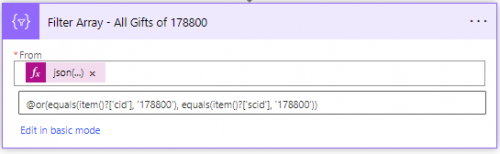

    So the filter array is trying to get from the list of all gifts returned by the 2nd query (adhoc gift query) where cid is of the constituent (in the loop) OR scid is of the constituent. (meaning any gifts that is direct or soft credit to the constituent).
    What you have now only looks at direct credit (cid) is the constituent, maybe the specific constituent you were looking at at run history only have soft credited gift so nothing is filtered.
    To do this, you can:
    • cid is equal to current item (you did this already
    • click on Edit in advanced mode and copy the expression for this, and paste to notepad
      should look something like this @equals(item()?['cid'], items('Applytoeach-CID'))
    • click to go back to basic mode
    • delete the cid dynamic content and do scid: item()?['scid']
    • click on Edit in advanced mode and copy the expression for this too
      should look something like this @equals(item()?['scid'], items('Applytoeach-CID'))
    • then in notepad do a OR condition
      should look something like this @or(equals(item()?['cid'], items('Applytoeach-CID')), equals(item()?['scid'], items('Applytoeach-CID')))
    • paste this whole thing starting with the @ symbol into the Advanced mode filter array
    After the filter array, you should have an array of all gifts direct or soft credit to the constituent id in the loop (cid or scid is the constituent id).
    Important: make sure your first query (constituent query that is saved in database view) is outputing the Constituent ID field, not System Recod ID, in this whole flow, we are going to use query API and only using the “lookup id” (per naming used in the SKY API).
  • @Alex Wong- I actually did try to do the @or and it didn't work so thank you for laying out those steps. It did work!
