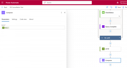

I have got as far as getting the query results and outputs but I am a bit stuck as the next stages to pass into a Apply to Each loop so the Send Email action can get the relevant fields per iteration and put in the email. Here is my flow so far with being able to see the results in the output of Compose.

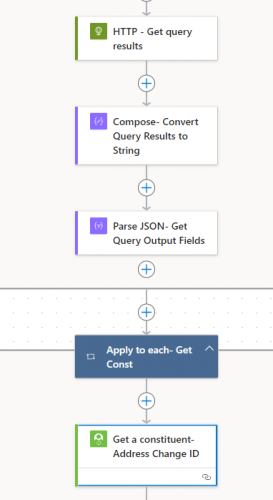

Hi- I can't see what is in your Compose but mine actually converts it to a string first in a compose. Also you need to make sure the System Record ID is in your query.string(body('HTTP_-_Get_query_results'))
Then you are correct, you want to Parse Json. The content area is where you put the Outputs of the Compose. Then you want to Generate from a sample schema. Here is one I used that just gets the basics I need which is the System Record ID.

After the Parse Json you should be able to do Get a Constituent and pull in the Parse Json field System Record ID and then it will do an Apply to Each.

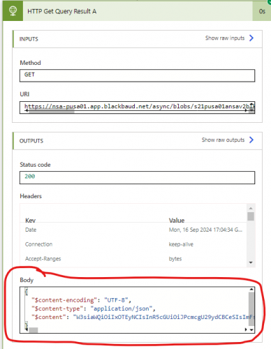

Assuming you use JSON, then you can run your flow, and go into run history.
In the HTTP action to download, you should see something like this:

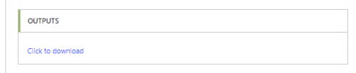

or your output can be like below if there are too much data, but if you “Click to download” it will show you data same as above.
You can see that the “content” of your download is in the $content property of the HTTP body JSON. it is “base 64 encoded”. so you will need to “decode” it before it can be used. There are 2 ways to do the decoding, one of it is mentioned by Carol already.

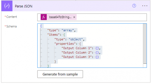

You can also directly use the $content dynamic content without “Compose”/String() first, but will use to use the base64ToString expression:
base64ToString(body('HTTP_Get_Query_Result')?['$content'])
"type": "array",
"items": {
"type": "object",
"properties": {
"Output Column 1": {},
"Output Column 2": {},
"Output Column 3": {}
In the Schema, you don't have to have each column data type explicitly defined, so meaning, using the above Schema, and just add more “output Column” name is fine.
