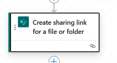

I would like the re-submission flow to include links to the new documents that were added after the original submission. The links to the images will be copied into the Excel spreadsheet. Is it possible to use a Create a shareable link to create links to these links in the spreadsheet?
@Susan Fioribello Hi Susan - You can absolutely use the Create sharing link action from SharePoint for this type of scenario.
You will need to supply the Item ID for the images in this action so you will need a way to programmatically identify which files/images correspond to which form/submission. As long as you can do that, this action should work well.

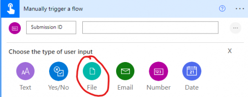

Your second flow is not going to have all the information that was previously submitted, you will have to retrieve that in some way first. All form created will have an associated excel file on sharepoint or onedrive (depends if your form is “my form” or “team form”). Every submission is going to have an ID, you will need to provide your second flow the “ID” for the specific submission in question, and use the “get a row” action in the excel connector to get all the details from original submission. THEN come the next piece, which is what was missing. You are going to need to provide the second flow, the file (image) that was missing. You can add a file input into your manual trigger (2nd flow):
This will allow you to specify the file to upload to this flow when you trigger the flow manually. Instead of “copying” the file to sharepoint manually, you can upload to the flow, and have flow save to the sharepoint location programmatically, better process that way. Then you can include the same actions to get the file item id and create share link and approval action
@Alex Wong
When I add the upload file option it only allows me to add one file. I can add it multiple times, but each time becomes a required field.
Is there a way to add a variable number of files?

I am able to use the Split function (thank you for that tip) but now I cannot figure out how to use it to create a sharable link for use in the Approval.
The Excel document is on Sharepoint. I tried to use the action “Create sharing link for a file or folder” but it is asking for the item ID. The “Get a row” action is not available, and the trigger number is not working.0 -
@Susan Fioribello Yes the “Create sharing link for a file or folder” does require the Item ID. You should be able to get that using the “List folder” or “Get files (properties only)” action, and then filter the output of one of those actions to find the actual file you need.
@Susan Fioribello
click on the 3-dots. you can make the input optional0
