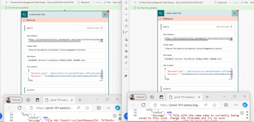

This morning our acknowledgement flow is giving us grief. I'm using the Acknowledgement Flow that I published in 2023.
It failed yesterday with a “404 Error” and message "File Not Found\\r\\n…" and I don't understand why. During some testing today we changed the letter code to one that worked the day before and now I'm getting a “400 Error” with the message “A file with the same name is currently being saved to this site. Change the filename and try to save again.\\r\\n…” (I confirmed the file does not exist in the folder we are trying to create the file.) I also tried adding a delay before the Create Letter files step and still receive the same error. Below is a snip of the flow.
I'd appreciate if someone could let me know what I'm missing or suggest additional things to test. I'm not sure what could have changed in the last 24 hours to create this error.

create file in sharepoint action has never really reported wrong error code, so i'm 99% certain that the error code is correct.What could happen:
- someone changed your flow (if other have access)
- someone changed the sharepoint location folder structure (intentionally or accident)
file not found error can be b/c the folder you are trying to save to is not at the location flow expect it to be. Then not sure what you may have done, but the flow ran again and the same “location” to save the file now already have the file there.
to troubleshoot:
- edit the create file action to select the folder path and see if you can “drill down” to the same folder
- update the file name with a random file name: you can use rand() expression to get a random number to add
- This is my file name for my eReceipt SKY Add-in: tmp_ereceipt_@{triggerBody()['number']}_@{rand(1, 1000000)}.docx
- Unless you “hardcode” the subsequent actions that uses this word doc file, you should not need to make any change to the rest of your flow.
@Alex Wong?
Thanks so much for your feedback Alex. As I was digging in on your suggestions, I noticed that the constituent name had invalid characters that I had not accounted for in my replace step. Once I added %28 & %29 to the replace step, the flow worked. I wish the error codes were more clear ?.I use the gift id and date in my naming to mimic a random file name format so I've never had any issue with the file name already existing. However, I can see the Rand expression being useful in other cases. Thanks!

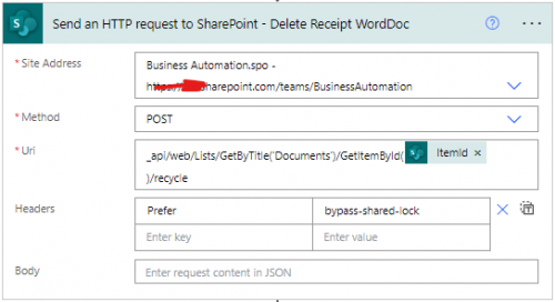

If you want to do the delete file in the flow, you may have an issue with the file still being “open” by the flow, so to ignore that and still delete, you can do:
Select Method=POST and Uri body is:
_api/web/Lists/GetByTitle('Documents')/GetItemById(@{outputs('Create_Receipt_WordDoc_01')?['body/ItemId']})/recycle
where ItemId is from the Create file action's dynamic content
and in the Headers: include Prefer: bypass-shared-lock
