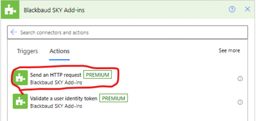

- try using Blackbaud SKY Add-ins connector's Send an HTTP request action

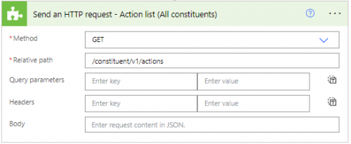

Could you tell me how to find the relative path for action lists? I've never used an HTTP request action before, so I'm not familiar with the process.0 -
@Kelsey Greaves

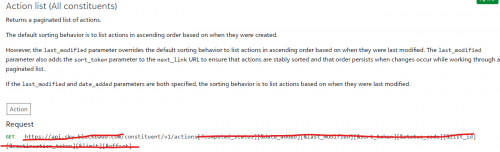

You can find the “FULL URL” path on developer.blackbaud.com:then it is just removing the beginning part and query parameter parts:
There is a good post that teach you how to use HTTP request:
