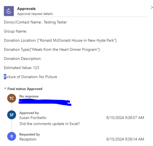

But you can see that there is data in the Approved by field of the Approval:
The comment “Did the comments update in Excel?” did update in Excel but my name did not get updated.

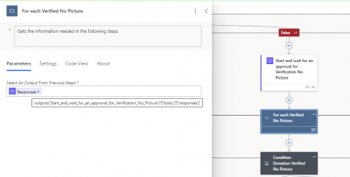

Hopefully this what you need and can see it. The flow is pretty large, this is the section with the two Approvals. There are several update row actions due to the various conditions, but they are all mapped the same way.All of the fields in the Excel file update with the exception of the Approved by field.

Here is the code for the “for each” (I don't know if it is relevant)
"type": "Foreach",
"foreach": "@outputs('Start_and_wait_for_an_approval_from_Finance_No_Picture')?['body']?['responses']",

This is from the Parameters section of the “for each”
"foreachItems": [
"responder": {
"id": "503bf3b4-38ee-4435-b57f-d735009e1e46",
"displayName": "Susan Fioribello",
"email": "sfioribello@xxxx.org",
"tenantId": "e97cf2ea-7bdd-45f0-882e-0f1d87edb37a",
"userPrincipalName": "sfioribello@xxxx.org"
"requestDate": "2024-08-15T19:15:20Z",
"responseDate": "2024-08-15T19:15:43Z",
"approverResponse": "Approve",
"comments": "This comment should now be updated in Excel."
