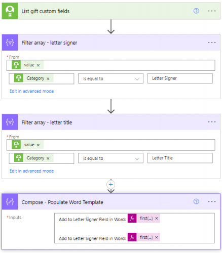

- Use list gift custom fields action
- use Filter Array on the returned “value” dynamic content, (make sure it is the “value” dynamic content that say “The set of items included int he response”), and filter on category = “Letter Signer”
- use a 2nd Filter Array on the same returned “value” dynamic content, and filter on category = “Letter Title”
- Filter Array will return an array EVEN when there is only 1 custom field matched. So you will have to use a “first()" expression on the 2 Filter Array actions.
NOTE: DO NOT use New Designer of flow, there is a bug with the New Designer that Filter Array dynamic content is selected incorrectly. Use Old Deisnger.
Expression used in the Compose (where you will use in your Populate Word Template action):
Add to Letter Signer FIeld in Word: @{first(body('Filter_array_-_letter_signer'))?['value']}
Add to Letter Signer FIeld in Word: @{first(body('Filter_array_-_letter_title'))?['value']}

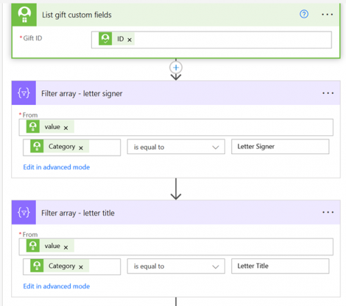

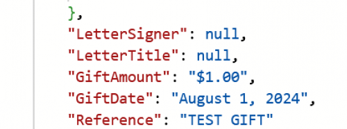

@Alex Wong - Thanks Alex - I should have known that one. I have it running now, but it's not showing the LetterSigner or LetterTitle in the raw input, but it's on the RE gift record.
I also noticed that the individual letter outside of the apply to all has something funky in the salutation field. Any idea how to fix this?
@Carla Murphy
Check the list gift custom fields action to make sure you got custom fields back for the gift system id you specified.Then check your filter array action to make sure the input and output is correct (show some screenshot of the edit mode of those actions and run history)
