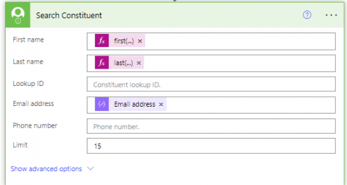

There is a search constituent with email option.0 -
@Alex Wong

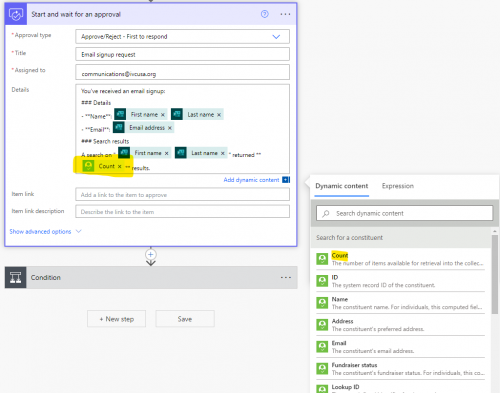

Thanks - the problem is that I need the count output for my approval email, and I don't see that in the enhanced search field list.0 -
@MaryKathryn Odean
Question is.. what is the purpose of this count other than just mentioning it in the approval that search found X number of matches.0 -
@Alex Wong for the reviewer to decide whether to approve or reject the creation of a new record. Ultimately I'd like to automate this into logic (if count is >0 do not create a new constituent record; if count is 0, create a new record), but haven't gotten that far yet. If someone signs up for emails but is already in RENXT we don't want to create new constituent records.
@Alex Wong if there's a better way to automate an email signup process using Power Automate that doesn't just create a bunch of duplicate constituent records, I'm all ears. It blows my mind that RENXT/Online Express doesn't have an integrated email signup form that allows for additional fields / or subscribing to various enewsletters.
@MaryKathryn Odean
Understood, while there is no Count dynamic content, you can use the length() expression to determine how many search result were returned:length(outputs('Search_Constituent')?['body/results'])
