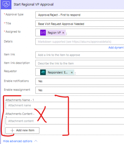

Now we want to attach multiple pictures. This is where I am having problems.

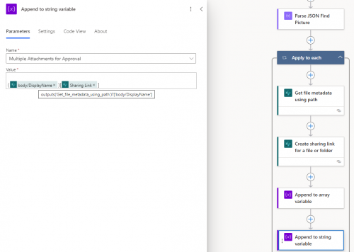

I attempted to create an Array variable and went through the steps I found online. The problem is the attachments are exceeding the size limit imposed by Microsoft for attachments on Approvals.
I created a String variable following the steps from this article, Solved: how can I add MULTIPLE attachments shared links in... - Power Platform Community (microsoft.com). However, there is still a problem. The links are live in the Approval card that sent via Teams but not in the Approval email.

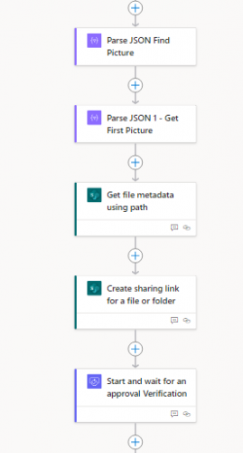

    This is section of the flow you helped me write to attach one picture. How can I edit it to allow for multiple pictures?
    In answer to your question: “in the Details field, you can add links to the attachment (attachment is parsed with a sharepoint/onedrive location), which is what I thought you did in your previous post about handling file submitted in MS Form.”
    Yes, this is correct. This is a sharepoint/onedrive location but it is a shared form. Not sure if that makes a difference.
    Do I still need the “Parse JSON 1 - Get First Picture"?

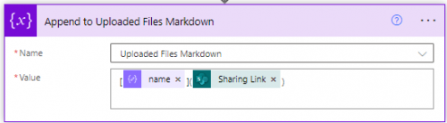

  • @Susan Fioribello
    the flow should be something like this (assuming the file upload is a required question)
    • trigger for form
    • get form response
    • initialize a string variable - Approval File Upload Markdown
    • Parse JSON of the answer to the upload question (JSON Schema to use)
      • {"type":"array","items":{"type":"object","properties":{"name":{"type":"string"},"link":{"type":"string"},"id":{"type":"string"},"type":{},"size":{"type":"integer"},"referenceId":{"type":"string"},"driveId":{"type":"string"},"status":{"type":"integer"},"uploadSessionUrl":{}}}}
    • Apply to Each File Uploaded dynamic content (loop through each file uploaded)
      • create a shared link
      • Append to the Approval File Upload Markdown String variable:
        concat('[',items('Apply_to_Each_File_Uploaded')?['name'],'](',ShareLink,'); ')
    • then somewhere in your Approval action, Details box, you will put the variable Approval File Upload Markdown

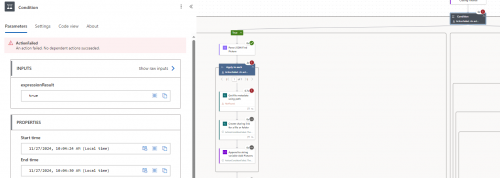

  • @Alex Wong

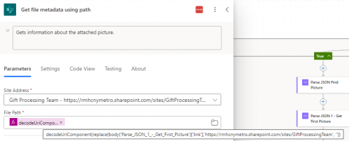

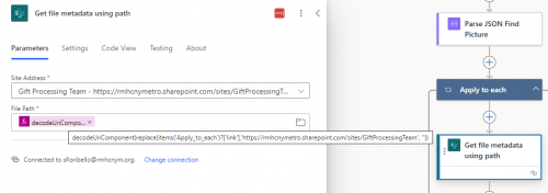

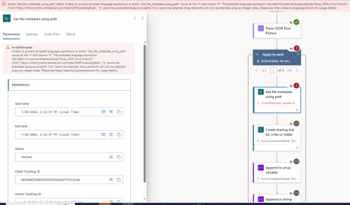

    I cannot get this to work. Currently, I can't get passed this:
    Error message at top:
    “Action 'Get_file_metadata_using_path' failed: Unable to process template language expressions in action 'Get_file_metadata_using_path' inputs at line '0' and column '0': 'The template language expression 'decodeUriComponent(replace(body('Parse_JSON_Find_Picture')['link'],'https://rmhcnymetro.sharepoint.com/sites/GiftProcessingTeam', ''))' cannot be evaluated because property 'link' cannot be selected. Array elements can only be selected using an integer index. Please see https://aka.ms/logicexpressions for usage details.'.”
    Error message for Get file metadata using path:
    "InvalidTemplate
    Unable to process template language expressions in action 'Get_file_metadata_using_path' inputs at line '0' and column '0': 'The template language expression 'decodeUriComponent(replace(body('Parse_JSON_Find_Picture')['link'],'https://rmhcnymetro.sharepoint.com/sites/GiftProcessingTeam', ''))' cannot be evaluated because property 'link' cannot be selected. Array elements can only be selected using an integer index. Please see https://aka.ms/logicexpressions for usage details.'."
    dcb960134f41fc1e820125b05da19d99-huge-im
    I searched the internet like crazy and nothing I have tried is working.
    BTW, the array variable is there because I was trying to make that work but it doesn't. When I add the array then the combined size of the attachments is too large.

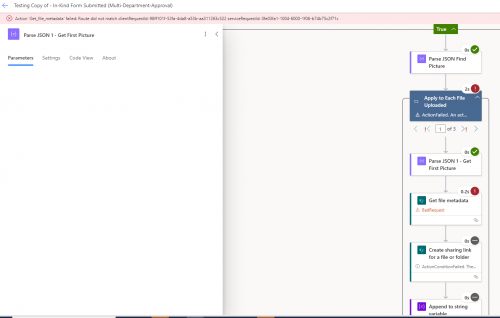

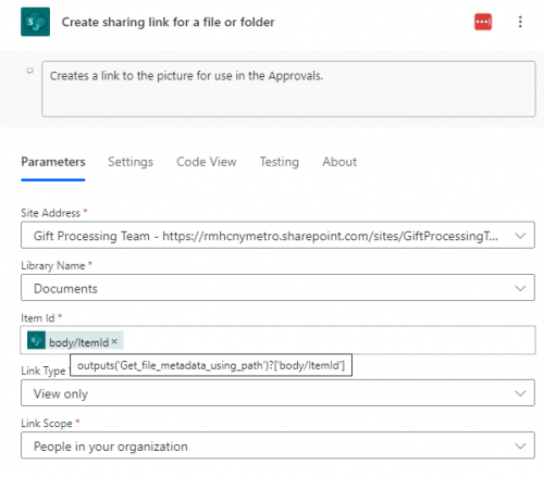

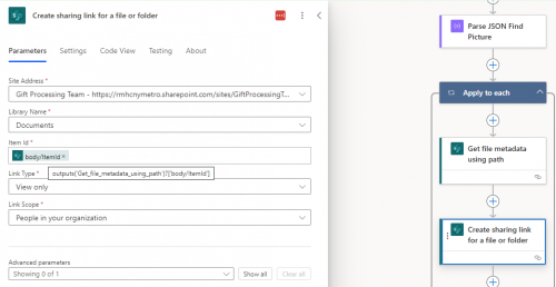

  • @Susan Fioribello
    indead of body('Parse_JSON_Find_Picture')['link'] in the expression used in Get file metadata using path action
    since you are in an Apply to each array of uploaded file, you should be using
    items('Apply_to_each')?['link']

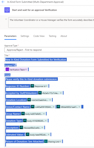

  • @Alex Wong

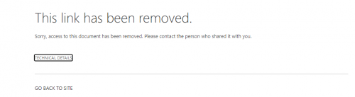

    Thanks Alex. The flow now works but there is still a problem.
    The links in Teams are clickable but when I click on them a new page opens in my browser with an error message:
    "This link has been removed.
    Sorry, access to this document has been removed. Please contact the person who shared it with you."
    The links in the email aren't clickable but if I copy and paste them into a browser I can get the picture.

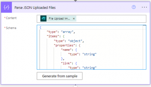

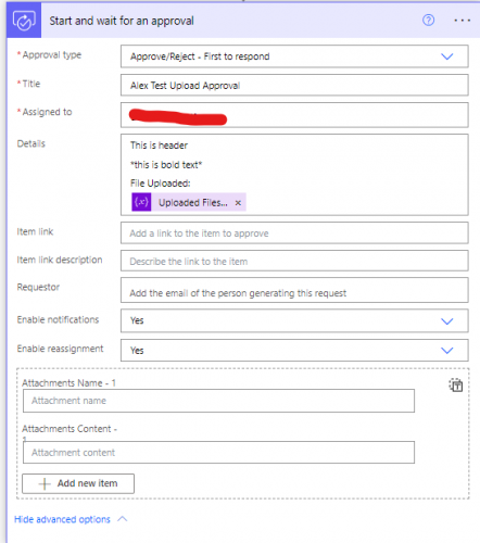

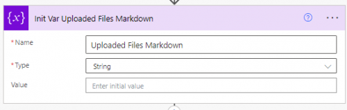

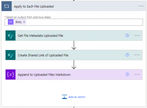

  • @Susan Fioribello
    Your screenshots looks correct to me and I just tested it and it works perfectly for me:
    d347489bbfe4ad8800ae6215f5801fe5-huge-im
    c630f4094b0becc7e1fb41573a2d51f6-huge-im
    c2f71393ef81af3c4cd4cdb9dd03751c-huge-im
    body('Parse_JSON_Uploaded_Files')
    24eee20c33768b756b0f7ec78b6f0a8c-huge-im
    decodeUriComponent(replace(items('Apply_to_Each_File_Uploaded')?['link'], 'https://xxxxx.sharepoint.com/teams/BusinessAutomation', ''))
    d77d8c0bdc4e735a52cc58904cd6ace4-huge-im
    outputs('Get_File_Metadata_Uploaded_File')?['body/ItemId']
    337fbe207362a5a3d2d631e5ad5deaf6-huge-im
    [@{items('Apply_to_Each_File_Uploaded')?['name']}](@{outputs('Create_Shared_Link_of_Uploaded_File')?['body/link/webUrl']})
    a1b5065093ec1f40cafabf0c1269a86b-huge-im

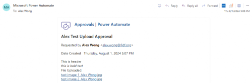

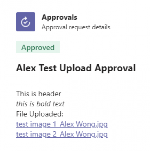

    Result:
    Approval in Teams:
    bf205b1464d3a7104382e71d864c05d8-huge-im
    both links works and takes to browser and showed images
    Approval in Outlook email:
    22eae13ba5c07609b0b155f7786bb179-huge-im
    link also works

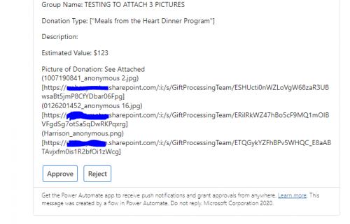

  • @Alex Wong

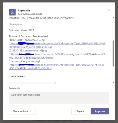

    Here is what I am getting
    Teams
    3e0fcd657da64f51e7f7e237774a922c-huge-im
    Email (links are not clickable)
    9e170608e5f35ab986287be5666302c4-huge-im
    If I click on the link in Teams I get this but if I copy and paste the link I can get to the picture.
    7ff8dcb2cf986669f5d6dd560294ac0d-huge-im
  • @Alex Wong
    Never mind. I figured it out. I was using poor grammar.
    I mixed up the ( ) and the [ ] so instead of
    [Name](link)
    I was writing (Name)[Link]
    Now that I corrected it it works!
    Thank you for bearing with me. You ROCK!!!!

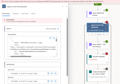

  • @Alex Wong
    I have a follow-up question for this process.
    Adding the multiple attachments has been working great; however, I have one flow that keeps failing. The only thing I can determine is that the attachment is a Word doc not a picture. I wrote the flow intending for Pictures.
    Could the problem be that it is a word document? If so, is there a way to fix it or do I need to limit the attachment type?
    Here is the Error message:
    Action 'Get_file_metadata_using_path' failed: File not found clientRequestId: 8e9c6083-f44c-495a-a82b-9924f9bd326b serviceRequestId: 3c0568a1-7097-7000-250d-0353031fccea
    Here is where the failure is occurring:

  • @Susan Fioribello
    The error message is pretty clear: “File not found”.
    Obviously the file uploaded exists, so meaning something is wrong in the input you provide to the Get file metadata using path action.
    You need to provide edit mode of Get file metadata using path action and a run history of this action. Your screenshot was not correctly giving info on this action, rather was on the condition action.
