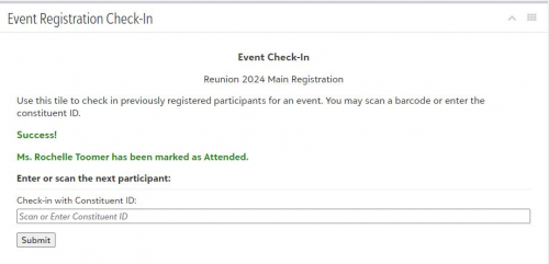

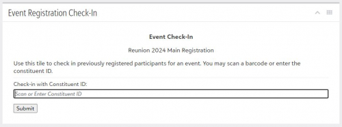

I'm sharing the adaptive card that I created to streamline Event check-in. We used it successfully at reunion a few weeks ago. We pre-printed the name badges that display a small QR code on them, via our third-party event registration software (Entegy). When a participant arrives to check in, we pull their badge, scan the QR code directly into the adaptive card, and click “Submit” to mark the participant as Attended. No typing in a name or searching a list, and certainly no printed lists with pen marks to enter in later…!
Description: This adaptive card displays as a tile on any Event record in NXT. The user can scan or type in a constituent ID and click Submit to mark a registered participant as “attended” in the Event record. New: If successful, the Adaptive Card will let you know the name of the attendee that was checked in and the text box will clear so you're ready to check-in the next participant.
Notes: The add-in will only check-in full constituents already registered as participants for an event. It will not check-in non-constituent guest participants, though the flow could easily be adapted to use participant ID instead of constituent ID.

Screenshots:
Update:

In case you haven't seen it, check out this post which describes a new capability that might be useful for your scenario. Instead of returning a toast message with an instruction to refresh the page, you could return a new card (essentially the same as your original card but could also include your toast message). The new card would replace the original card, and the end-user would see that the check-in was successful, and the textbox would be cleared and ready for the next data entry).
@Ben Lambert Thank you!!!! I am way late to the party! ?
@Ben Lambert Thanks again, Ben! I updated my flow to include the additional adaptive card.

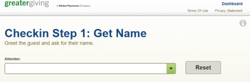

In our world, I would need the Lookup to be “Check-in with Constituent name.” Do you think it's plausible (or even wise) to do that?
I ask because my colleagues are also trained in Greater Giving (a third party even platform we use for our larger fundraiser events because of its auction capabilities and more). They are used to this screen for registration:
If I could give them a familiar step in NXT, they'd be much more comfortable.
