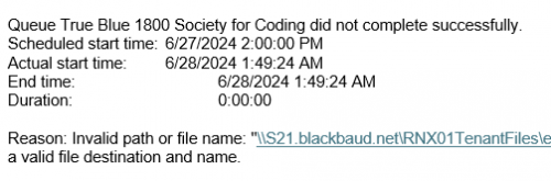

Here is the PA error and also showing that the path does exist. Now this morning I got a 504 Bad Gateway with Request to the SFTP server has taken more than '00:00:30' seconds. error message.
PA error File location does exist 0 -

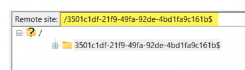

The flow that is working is going to the general FTP folder while this is a separate folder, just …/Power BI.Also, when I go to navigate to the folder as you suggested, the Power BI folder does not show up so there must be a permissions thing going on.
@Dan Snyder
permission maybe.You can check this by using a standalone sFTP client (i.e. FileZilla) and login using the username/password that you use on the SFTP PA flow connection object and see if the Power BI folder shows.
Also possible that sFTP can only see folder inside the FTP folder. That's where I put subfolder for my sftp work before, everything inside the FTP folder.
@Alex Wong Thanks for asking those questions. I nested the Power BI folder within the FTP folder and that seemed to have fixed the issue. Still need to update to using Query API, but for those others I think you have solved the issue for now!
