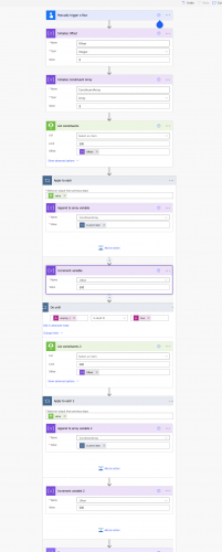

  • Hey @Chris Zello, this is how I'd go about solving this (there's probably easier ways).
    I know the image might be hard to see, here's a link to the full size image.
    Essentially, start by initially two variables, an Offset number, and Constituent Array.
    1. Execute the first List Constituents action with the max number of constituents in the limit field (5,000) and the Offset variable value as the Offset.
    2. Put the return value of that action in an Apply to Each and append each value to the Constituent array.
    3. Outside of the Apply to Each, increment the Offset variable by 5,000
    4. The next is a Do While step. In the left hand side of the Do While condition, use the expression empty(outputs('List_constituents')?['body/next_link']) and the right side is ‘true’
    5. Do another List Constituent action with the Limit and Offset Variable
    6. Iterate over the returned values and append to the Constituent array
    7. Increment the Offset by 5,000
    So this will continue until there the flow reaches the last page in pagination. After this section, you can work with the Constituent array in the rest of your flow.
    You might want to add a Parse JSON action after this section so that you can work with the attributes of the array, rather than having to hardcode them into your flow actions.

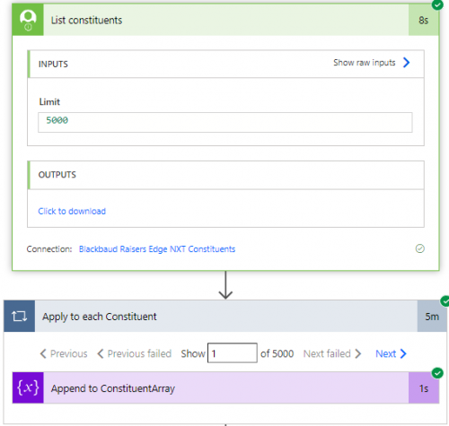

    You can also follow Matt's instruction, but I would advise against step #2 Put the return value of that action in an Apply to Each and append each value to the Constituent array.
    putting each constituent record into an array using apply to each means you are looping 5000x for each 5000 records, this will take a long time. Instead, you can either

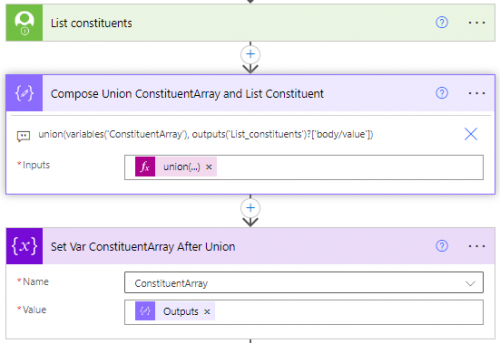

    1. do one list constituent action which is inside of the do until directly, and do the processing you want to do directly in the do until loop
    2. use compose to join what's in the array variable using the union expression with the new list of 5000 records

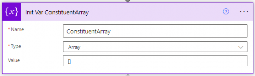

      1. initialize constitent array as empty array []
      2. after the list constituent action, use Compose action to union the constituent array with the array from list constituent (body/value)
        union(variables('ConstituentArray'), outputs('List_constituents')?['body/value'])
      3. then set variable action to set the constituentarray variable with the now combined array from the compose action.

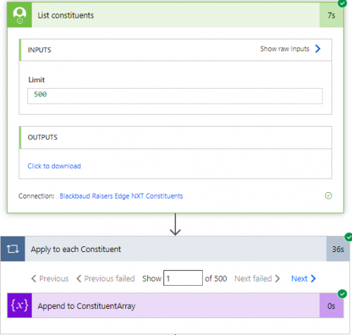

    Yes, concurrency will increase the speed Apply to Each runs, however, it is still processing each constituent one at a time, the overhead of running loops is heavy.
    15b416e1669024f38dcedd840b269711-huge-im
    1660eca536bf0bffc8b96c2f06689762-huge-im
    With 20 concurrency setting, a 500 record limit took 36s, while a 5000 record limit took 5 minutes, just about 10x (directly proportional to # of records.
    However, using union and set var does not need apply to each and the 2 actions only takes 3s total, for both 500 records, or 5000 records
