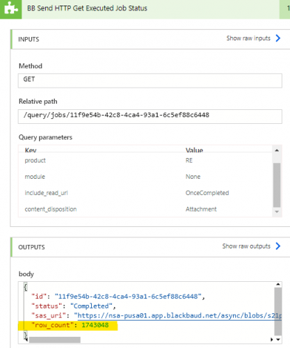

Actually, it's simpler than that lol.
In the get execute job status, on the one that you got the sas_uri, there's a property (new) “row_count” that shows on JSON or CSV output option.
@Alex Wong- Thank You! That worked, there was an extra parentheses in the highlighted area below, but that worked.
