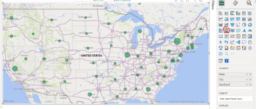

I'm using this visualization:did not get a prompt.
I will keep an eye out as well, thanks

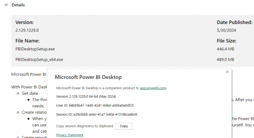

Have you updated Power BI Desktop recently? I didn't get the prompt until I updated.0 -
is the same version as the one from the download page for Power BI Desktop.
https://www.microsoft.com/en-us/download/details.aspx?id=58494
So I think I have the latest version
