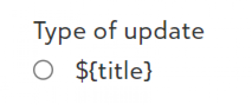

  • @Dan Snyder question about the Type of update. My adaptive card is showing the below text instead of the values. This is happening through out the card where the JSON has the “title”: “${title}”. What steps can I take to resolve this.
    ef7f098224fab335a62c6249ffdf9565-huge-im
    Thanks in advance for any recommendations you may have.
  • @Wendy Bondeson
    you can change the adaptive card JSON and remove the ${title} and use the actual text in double quote, though you do need to know what is the expected value of this dropdown choice set.
    “choices”: [{"title":"Address update", “value":"address"},{"title":"Phone Update","value":"phone"}]

  • @Dan Snyder, I did build the SKY Add-In URL following these instructions. Thanks for confirming!
  • @Ashley Moose did I miss a step for it not to populate the data items.
    My card shows this, so I changed up the JSON to populate.

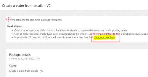

  • ETA: The errors are both on the flow import itself, and not the related resources (i.e. connections).
    @Dan Snyder I've been able to import the two Constituent Update (Template/Data) Card flows, but both of the Process Constituent Updates from Adaptive Card (SharePoint/RENXT) flow imports are throwing the following error:
    Flow save failed with code 'DynamicOperationRequestClientFailure' and message 'The dynamic operation request to API 'sharepointonline' operation 'GetTable' failed with status code 'Unauthorized'. This may indicate invalid input parameters. Error response: { "error_description": "Exception of type 'Microsoft.IdentityModel.Tokens.AudienceUriValidationFailedException' was thrown." }'.
    Any ideas?

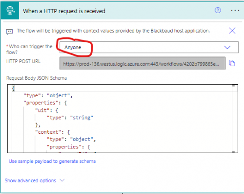

  • Hi @Kevin Fletcher - This is a common error that can occur when importing flows that use SharePoint lists. Normally there is an option at the top of the flow to Save as a new flow. Do you see this option like in the screen shot below (sorry it's blurry, that's just how it's pasting in)?
    cc88c29571ede480e5499fe8e9bb803c-huge-im
    If you don't see that option, try importing from a different browser. I've had it not appear for me before but then appear when importing through a different browser.
    Please let us know if you're still not able to get this to import!
    CC: @Dan Snyder
  • @Ashley Moose That third bullet with SANF didn't even display on mine in Edge, but it did show in Firefox and I was able to Save As and go from there. THANKS!
