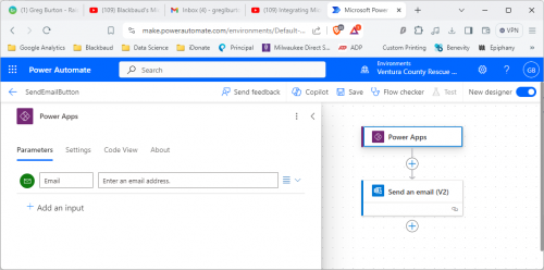

I have a tile on constituent records that will be used to send an email to the constituent. I have a PowerAutomate flow being triggered by a PowerApp button. Since the 2 are connected, the PowerApp add-in tile knows what record it is on & the button is sending info to PowerAutomate I can't figure out why “Ask in PowerApps” is not showing up under dynamic content in the PowerAutomate flow like it does in all of the demo videos I watch. Any suggestions?

- In the Power Automate for the button in Power App, change the trigger from Power App to Power App V2, much better control of parameter passing between Power App and Power Automate

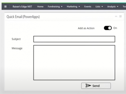

Currently fundraisers have to copy the email address, open Outlook, create & send the email then go back into NXT to record the action. I want them to be able to do all of that from this tile.I got the same results from using Power Apps (V2).

If you really want to get the PowerApp to work, like I said, use PowerApp V2, but you have to know how to use it, it doesn't magically work.
From within the Power App you need to call the Flow and provide the parameter needed by the flow to send email to it.
UpdateContext({FlowResponse:'SMSNXT-AddAssignment'.Run(varSelectedGift.REGiftSysID, 'DataTable-Student_A'.Selected.ImpactId, Int('Input-Amount_A'.Text), varDefaultYear, "Confirmed")});

Thanks for the info, Alex. This is what I was trying to create. I saw this in a BB Sky Developer video from 2 yrs ago. I'll give your “workaround”, the BB Outlook add-in, a try. Looks like it will do the trick.0
