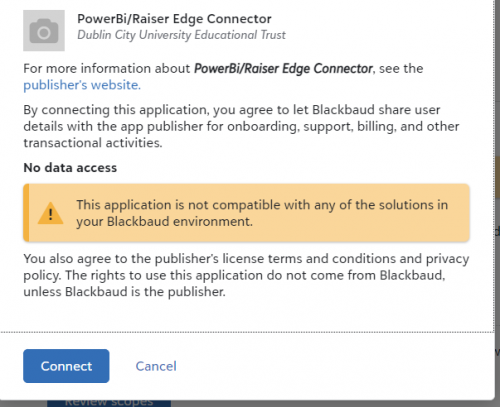

I'm trying to set up the Power Bi connector, following this instructions:
When I go to RE NXT and try to connect the app, I see an error message saying "
This application is not compatible with any of the solutions in your Blackbaud environment." (see screenshot below)
What did I do wrong and how can I fix it?
thank you
Anna
When editing your PowerBi/Raiser's Edge Connector App, look at the lower left side of the app setup under ‘Scopes’. This is an additional level of security. If you haven't already done so, you'll want to setup at least “Limited Data Access” with Read for Raiser's Edge NXT. After making that change, you'll have to go back to the App Management Area in the Marketplace to accept that change.

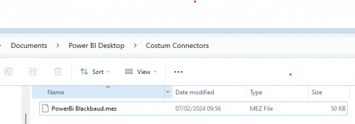

@Anna Silvestri
there are a few reasons why “Blackbaud” doesn't show up in power BI Desktop, starting with the file you created is not in the right format.Can you screenshot where you saved the file and the file itself with the “extension” of the file shown.
@Alex Wong
Thank you Alex! Here the screenshot:0 -

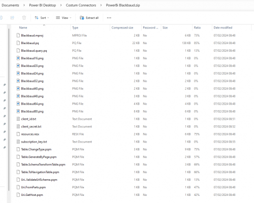

@Anna Silvestri
location and file itself is ok.next is to make sure you “zip” the files correctly. If you were to rename the file back to a .zip file extension, open the file, do you see a Blackbaud folder, or do you see the 22 files directly.
Screenshot will helps.
issue i'm talking about is sometime, people zip the “folder” of blackbaud instead of directly the 22 files, which is not correct.
@Alex Wong
Thank you again Alex. I see the 22 files:0 -
@Anna Silvestri
Then it looks like you got all the steps correct.I have seen this with some other user before, you can try uninstalling power bi desktop and reinstall. Also, try to install Power BI Desktop on another computer and place the mez file in the correct location and see if it loads. OneDrive sync of location folder sometimes affect this as well.

Hi Anna,
The problem is the folder name. It needs to be "Custom Connectors" but it's currently misspelled as "Costum Connectors". So, rename it accordingly and everything should function correctly.0 -
@Amir Sohani
good eyes! totally missed that1
