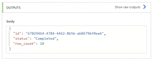

what you get back is the same as when you execute a query by id (or adhoc). So you will use the same logic to check status in a loop. When status is completed
you will get the job id back (not useful), status, and row_count, which I can only assume it is the new # of records from the status query after it has been refreshed. If any NXT webview list is using the static query, that list should now be updated (given normal NXT list refresh timeframe).

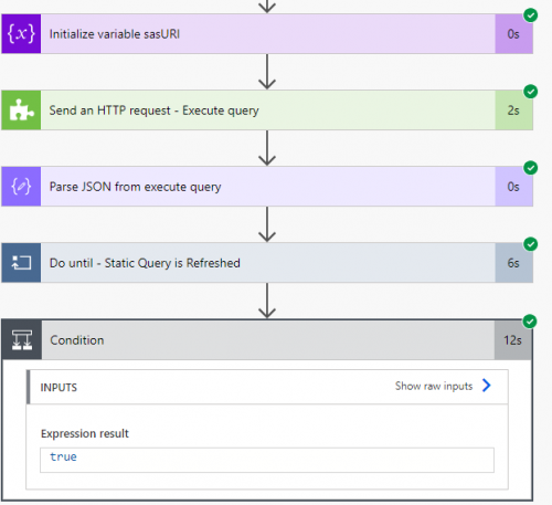

@Alex Wong- I did a few more tests- still no output. Here's my flow:
First part is refreshing the static query. The HTTP Request below is POST- query/queries/refreshstaticquery. I created another Refresh Status variable.

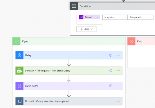

Then I have a condition where I set a Refresh Status equals Completed which is true below.
Then I have a send HTTP request again saying Run Static Query which is below.
A better view of what is in the Run Static Query.
Then I have another Do Until loop to see when it's complete and I have another Get Job results inside.

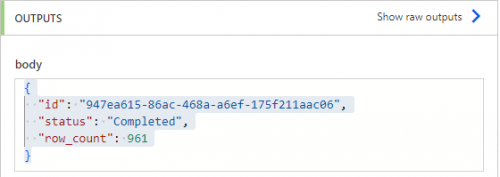

Which only returns this, no sas_uri in the output. I feel like it is still grabbing the results from the Refresh Post request and not recognizing the new POST which is execute by ID.
I can run the query fine after it refreshes in another flow but I think here it gets confused doing it in one flow using the same query id.

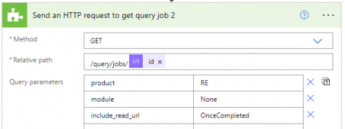

yes, you are correct, you are checking status of the “refresh” job.In your Send an HTTP request to get query job 2 action, what “id” are you providing it, it should be the id returned by your Send an HTTP requet - Run Static Query action.
@Alex Wong- just had a lightbulb moment! Thank you!! I had the wrong Query ID in the Send an HTTP request to get query job2. It was the previous one. It works now.
