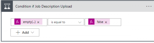

for an upload question in MS forms, here's what you need to do in the flow:- if the upload question is not required, first start with a condition where the question's response is not empty:
- Note that 'Get_response_details')?['re09684a5fefe4438b9b02e2713632575'] used anywhere below is the response to the question of the file upload.

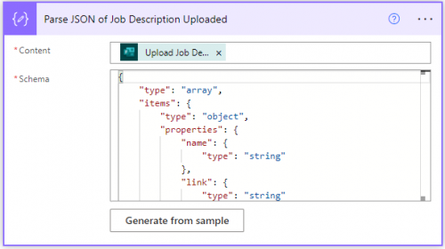

empty(body('Get_response_details')?['re09684a5fefe4438b9b02e2713632575']) - then add a Parse JSON action
Schema:
"type": "array",
"items": {
"type": "object",
"properties": {
"name": {
"type": "string"
"link": {
"type": "string"
"id": {
"type": "string"
"type": {},
"size": {
"type": "integer"
"referenceId": {
"type": "string"
"driveId": {
"type": "string"
"status": {
"type": "integer"
"uploadSessionUrl": {}
"required": [
"name",
"link",
"id",
"type",
"size",
"referenceId",
"driveId",
"status",
"uploadSessionUrl"

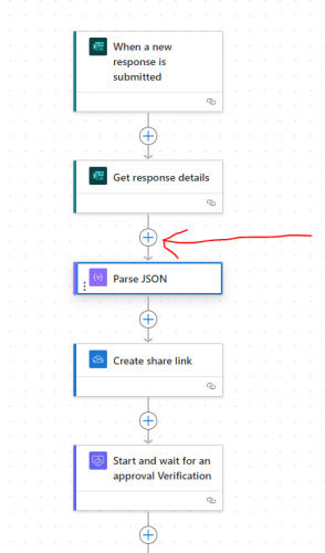

I know it's been a while, but I am circling back to this project.I tried following these instructions, but I could not get it to work. This is the start of my flow. Do I put the condition where the arrow is pointing?
The next part where you talk about the mark down language I am not understanding. Am I now starting two separate branches? Both will go through the same steps except one will not have the attachment?
@Susan Fioribello
Yes you can put the condition at the red arrow.then you will need to condition on if the upload question was answered by using the empty() expression, if not empty, then do the Parse JSON
