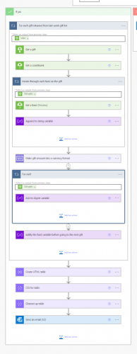

Here is a screenshot of the “yes” after the control.

@Austen Brown I have attached a copy of the export. This is the version that sends the complete digest. I want to send separate emails with the digest based on the fund. Thank you
@Sarah Homan

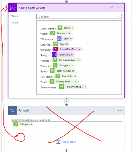

I'm going to assume you do not use split gift (if yes, you will have to determine if how to handle if a gift is split between 2 funds for 2 different executive director.)first, let's fix a unneccessary “for each”. Drag and move the Add to digest variable action outside of the For each action and then delete the For each action
delete the Create HTML table action (since you will be creating a new table that is used for each email to each ED.) and delete the Cleaned up table action.

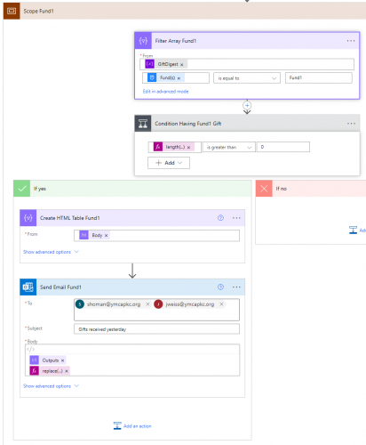

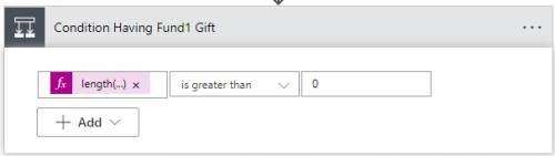

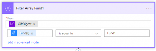

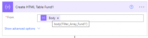

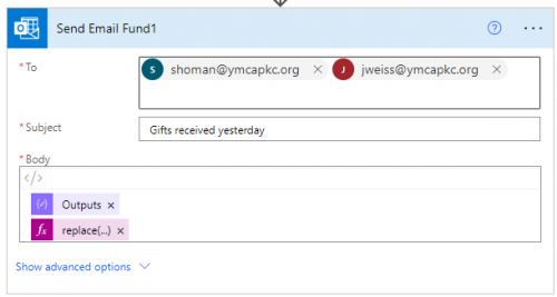

then outside of your For each gift returned from last week gift list action, you will use a Filter array action to filter the GiftDigest array for specific fund to specific ED, create the html table based on that filtered array (conditioning on there IS gift with the fund), and send the email to the specific ED using the html table created from the filtered array. one example below:
The use of “Scope” allows you to copy the Scope and then paste the Scope with everything in it for your Fund2, then Fund3, etc.
You will not be able to select Fund(s) from dynamic content, you need to type in the expression of item()?['Fund(s)'] length(body('Filter_Array_Fund1')) @{outputs('CSS_for_table')}
@{replace(replace(body('Create_HTML_Table_Fund1'), '<', '<'), '>', '>')}1 -
