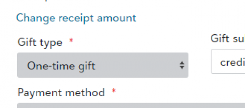

@Alex Wong
It won';t let me change the gift type it is greyed out0 -

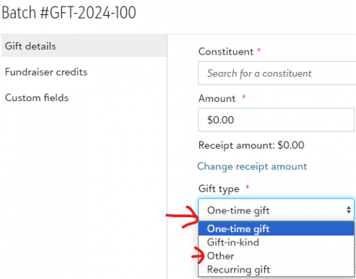

@Beth UnruhArnold
I was on RE NXT webview gift batch for my JustGiving batch and it allow me to change it (not grayed out as seen in my screenshot earlier). I'm not sure if you are in your situation b/c it is RE NXT event registration related and that's a limitation or not, you will have to ask support0 -

@Alex Wong
must be the registration process is different then the gift process. Mine are all greyed out when I select to edit the details.0
