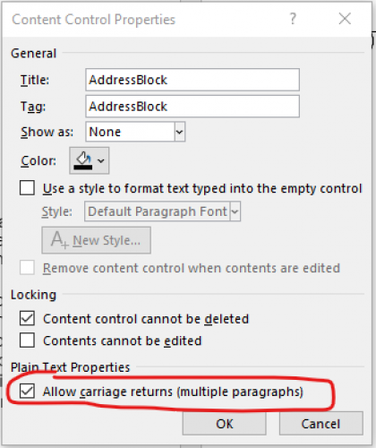

@Alex Wong follow-up question - what would I do to have each Custom Field display as a separate line - this is how it is coming through now:
@Reuben Schmitz
Oh wait… I think you were doing populate word doc… you have to make the text control field multi line0 -
@Alex Wong
Thanks again - thought it was something simple. All set. Appreciate your sharing your expertise with me (and the group).0
