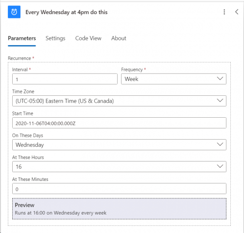

My Flow is running every minute instead of once a week
I have been working on my flow for a few weeks now, it has been quite the learning experience.
While I was testing the flow I had it set to run every minute so I could monitor my changes. Now that I am satisfied that it works, I reset the time interval to once a week; however, it continues to run every minute. What did I miss?

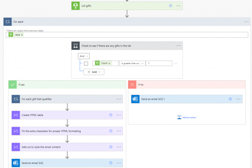

    It seems that once this flow starts it keeps repeating. I’m starting to think it has something to do with the “for each” step. Is that possible? I started this flow from one of the templets in the Blackbaud showcase.

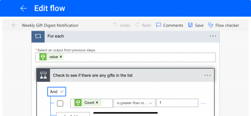

    A flow trigger based on how you code the trigger to start the flow (i.e. start the flow every Wednesday at 9AM EST; start the flow when a Microsoft form is submitted, etc). Everytime a flow trigger, there will be ONE run history in the run history section of the flow detail page.
    b850d8f014c6b7cac19800bf59b8199f-huge-im
    each of the run can be clicked on (click on the date/time) to see the run history information (all action's input, output, status, etc).
    Every flow has ONE trigger, but MANY actions. An action defines “what happen” next once the flow has triggered (i.e. send an email). If you are going to do more Power Automate, it will be important for you to learn some of the basic terminology used, so when asking for help, it is easier to help you.
    So it sounds like your flow is not triggering every minute, rather, your flow triggered once (check the run history in the detail page of the flow), however, there are some actions in the flow that is done in a LOOP (for each loop), which I'm going to assume it is the send email action (you get many emails and think the flow triggered multiple times).
    So to help you, first you need to point us to the template you were working from. Then it is to let us know what you are trying to achieve with the flow (i.e. 1 email per gift? 1 email per “set” of gift? or 1 email for the entire flow run).

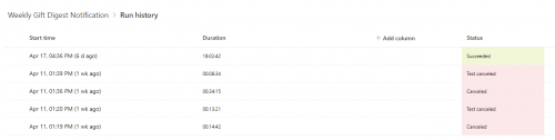

    Here is a list of all runs:
    23e186530fc109dd003a0c247b364a65-huge-im
    When I add the filter for just running it says there are no runs. Last week, when I let the flow start from the natural trigger (Wednesday at 4 pm) it started fine and sent me the email with the gift listed in descending gift amount order. It then continued to send me an email every 3 or 4 minutes until 10:38 AM Thursday morning. Over 100 emails. There were 145 gifts so this made me wonder if I have a loop that is causing it to send one email for every gift instead of one email if there is at least one gift.

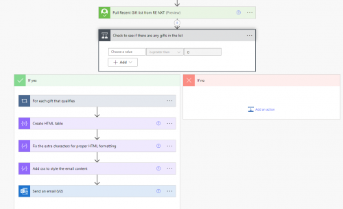

    Trevor post's flow:
    ce7debb22ac65e44fbe432b0bf166b43-huge-im
    after Listing gift (action named Pull Recent Gift list from RE NXT), it is conditioning to see if there are any gift to work on, if YES, then add each gift into a variable. THEN create the HTML table that shows the gifts and send it out in ONE email.
    This is yours:
    9dceff16da568d3999bddad281bd15e0-huge-im
    You have a For each action BEFORE the condition to check if there are any gift to work on, that's doesn't make sense in the flow. THEN within the For each action, you have the same For each gift action like Travor has it. Meaning now what you flow is doing is looping TWICE.
    Assuming there are 10 gifts in the list gift:
    Travor will have ONE loop that loops through each of the 10 gifts to gather info, and put into a variable that stores the 10 gifts to send in ONE email.
    your flow will have a LOOP in a LOOP. Meaning, you are going to loop 100x in total, and send an email out every 10x. Your first email will have the “real” 10 gifts. 2nd email will have the “real” 10 gifts but an additional SAME dup 10 gifts. 3rd email will have 30 gifts, so on and so forth.
    Not to mention you have another For each 1 action that loop gift splits array, which is yet another problem.
    So to answer your question directly, your flow did not trigger multiple times PER minutes. Your flow triggered ONCE only at the time you specified it to run. Your flow send out X number of emails, where X is the number of gifts returned by the gift list action. (if you got 100 gifts, you will get 100 emails, 200 gifts = 200 emails).
    Your flow can be fixed, but will be A LOT of typing that won't be good to do here in reply. Suggestion is for you to either discard this flow and download Trevor's flow zip file again and import it to have a fresh start. OR go to the next monthly Power Automate user group and we can directly you to fix your flow then.
