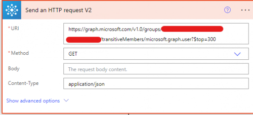

Yes, if you want to use a Distribution List on Office365, you can.You can use MS Graph API to get list of members in a Distribution List
red crossed out is the distribution lits's group id.
