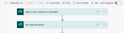

@Meghan Dinges
you will need your IT team to get you a per user license for power automate to startif you are just starting out with power bi, then you don't need a license yet, until you build something and want to put it on power bi service (on the cloud allowing others to see what you build)
as for the “version”, I think you are referring to the “new designer” vs “old designer”.
power automate is accessed by going to make.powerautomate.com, which has no “version” (not to us user). it is when you start to edit a flow, that you have the option to use New Designer (by default, MS will make you go into New Designer mode first, you will need to toggle away from New Designer).
New Designer look and feel Old Deisnger look and feel 1 -
