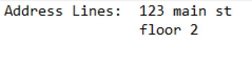

Address Line(s):
and split out the address lines dynamic content so it looks like this:If you still want to do the Addr1 and Addr2 route, then:
