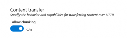

@Ashley Moose this is brilliant thank you so much! I tested it on a small query and it worked great but when I tried it with a query with lots of data being generated it came back with an error
Http request failed as there is an error:
'Cannot write more bytes to the buffer than the configured maximum buffer size: 104857600.'.
Is there any way around this for larger query results?0 -
Hi @Mark Palfrey - Unfortunately there is not, this is a Power Automate limitation, not a Query limitation. That said, there are 2 things to consider:
1. On the Create file action, make sure Allow chunking is enabled. This can allow larger files to be created (Microsoft documentation for reference: https://learn.microsoft.com/en-us/power-automate/limits-and-config#message-size )
2. If the error still occurs, the only other solution is to break your query up into smaller parts.0 -
@Ashley Moose thanks for getting back to me so quickly. I had chunking already enabled but to be honest with you looking at it more closely I was trying to query out 800k rows of data so I think I can streamline that a bit. I ran another test and managed to generate a file of assigned appeals with 500k rows and the flow took about 1min to run! This will be so powerful for us in our PowerBI reporting requirements at the moment.
