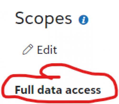

Hi @Alex Wong, I managed to make a connection to Blackbaud with my tweaked Power BI connector, but when trying load the tables all of them says "Expression.Error: Access to the resource is forbidden.". What/where else might I need to fix? Expression.Error - Access to the resource is forbidden.png

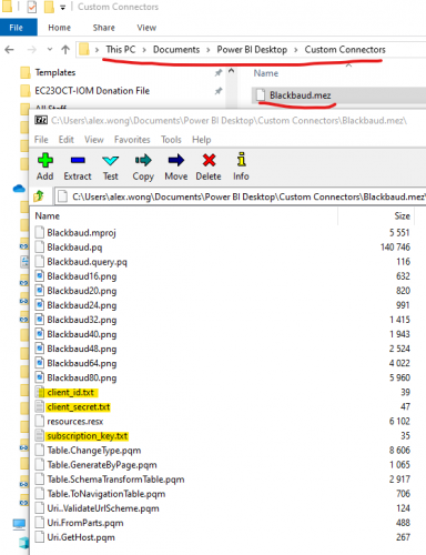

@Sam Chia
here's the big items to make sure:- the developer application access Scopes
- You added https://oauth.powerbi.com/views/oauthredirect.html as a Redirect URI in your developer application.
- Connect the MS Power Platform app: https://app.blackbaud.com/marketplace/applications/848afa1d-fe4a-4331-8e03-79ea0d000343
- You downloaded from: https://github.com/blackbaud/powerbi-connector
- You created the Blackbaud.mez (exactly this file name and mez extension) in the folder mentioned in previous post. Also the Blackbaud.mez file has all the files in it and if you were to open this file in a zip profile (like 7-Zip), you can see all the files directly without folder in the zip file (There were others before who zip the files with a folder, and that caused problem)
- ensure you updated the client_id.txt, client_secret.txt and subscription_key.txt with your developer applicatoin's Application ID, Primary (or Secondary) Application Secret, and your developer account subscription primary (or secondary) access key.
- Ensure your Power BI Desktop setting allows for custom connector
@Alex Wong, I have sorted out the access scope and tables are loading fine now. Thanks for useful advises!
