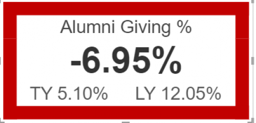

@Carol Grant Carol, I can explain where I am on our Power BI report with Alumni giving. Not sure if it is correct yet…but it looks good.
First I am using a KPI chart. In that chart, I am using several measures.
AlumGiving% = [AlumGivingNum]/[SolicitableAlumni]
AlumGivingNum = CALCULATE([CountAlumniDonorsTY]+[MarriedAlum]+[NorbertineAlumni])
CountAlumniDonorsTY = CALCULATE( COUNTROWS(FilteredAlumniData),
Filter(FilteredAlumniData,FilteredAlumniData[SumGiftsTY]>0 ))
MarriedAlum = CALCULATE([CountAlumniDonorsTY]*0.123)
LYAlumGiving% = .1205
SolicitableAlumni = CALCULATE(COUNTROWS('Constituent codes'),
FILTER('Constituent codes','Constituent codes'[description]="Alum Undergrad"),Filter(Constituents,Constituents[deceased] =False),
Filter(Constituents,Constituents[address.inactive]=False) )
AlumGiving%Diff = IF([LYAlumGiving%]>[LYAlumGiving%],[LYAlumGiving%]-[AlumGiving%],[AlumGiving%]-[LYAlumGiving%])
Married alums is a percentage against our overall alumni base. The rest is pretty much math. As I said…this is a start. I will refine as we finish out this year and I pull actual data and compare.
Not sure if this will help…but maybe someone will find this useful.
