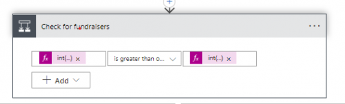

    @Jenny Burkhead - Can you provide a zoomed in screenshot of the control action?
  • @Austen Brown Is this what you are looking for? Thanks!

    @Jenny Burkhead - Thanks for that. I presume there are more actions that make up the flow after what is listed within your original screenshot. You'll need to re-arrange a few things starting with the “Check for fundraisers” control and the action whose output it uses in the expressions; these will need to be listed higher in the flow - from there you'll need to group the remaining actions together in the “No” side of the control split, in order to discount instances that have a fundraiser listed. You'll have to play around with this a little bit to determine the right order of things to achieve the output you're looking for.
  • @Austen Brown Thank you! I will work on it and post if I have equestions.
