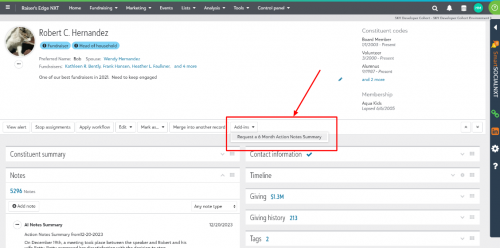

- End-user requests an Action Notes Summary from the Constituent record in Raiser’s Edge NXT.
- End-user receives a Toast message that their request has been received

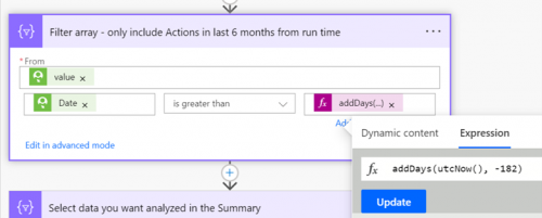

- Actions are filtered to those in the last 6 months and sorted descending based on Action Date

- For information on how to create a SKY Add-in to invoke a flow, see this tutorial. And check out @Ashley Moose's handy SKY Add-in URL Builder.
- You may want to change the date range of Actions that are analyzed. Edit the ‘Filter array – only include Actions in the last 6 months from the run time’ to the required number of days.
