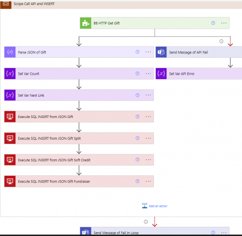

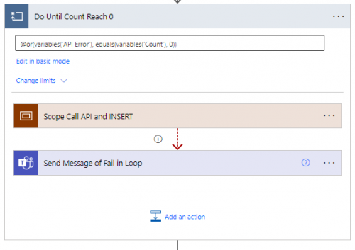

This is the basic idea:
loop until Count from API call is 0 or API Error is true I persist data in azure sql database, so it's easily for me to do 4 actions without looping each of the 5000 gift records that is returned from 1 API call. Depending on where you are persisting your data, you may need to loop, and if you do have to loop each gift, then your flow will run A LOT longer. 4 actions b/c I am recording each of the 1-many relationships of gift into its own relational table: gift splits, gift soft credit, and gift fundriaser

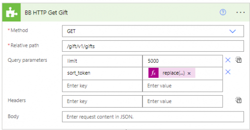

In the BB HTTP Get Gift action, here's what it looks like:
- the difficulty is you can't use next_link directly
- use of relative path
- query parameter cannot be added on the relative path, meaning the sort token must be “parsed” out
here's my expression specifically for gift:
replace(replace(replace(split(variables('Next Link'), '?')[1],'limit=5000',''), '&', ''),'sort_token=','')
As I know my next_link ONLY have 1 other query parameter on it “limit=5000”, so i'm using replace to get rid of it, then the & sign that separate query paramter, then finally get rid of the query parameter field name of sort_token=
