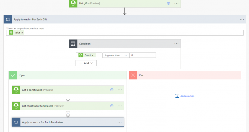

Here is a screen shot of the overview of the flow where it gets ready to assign. The “Apply to each - For Each Fundraiser” contains the switch statement, it is too large to screen shot, but like I said that part works.
6856513f7e640db85b7135e8e4e74885-huge-im
The switch statement is switching on the Fundraiser ID, so it kind of makes sense that if they don't have a fundraiser assigned there is nothing to switch on. I was hoping that would all trickle into the final “Default” switch, but that is not the case.

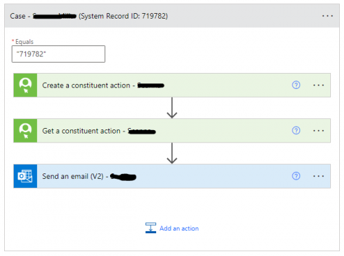

FYI, a single switch looks like this:
193d517844df2b5765026b2ed940037a-huge-im

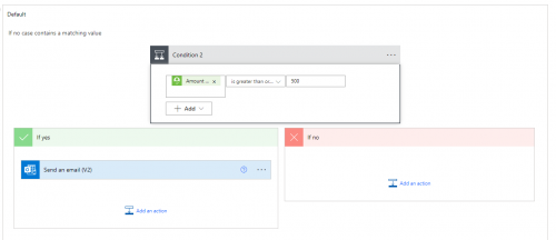

And the “Default” Switch looks like this:
daaeda1cdac5406ffdc83c607799fbd3-huge-im

    First of all, if the switch is working properly great, just find it odd that you had to put double quote around the fundraiser's constituent system record id to force “string” comparison. I don't remember needing to do this.
    as for the default case, it will never land there since there would be no fundraiser meaning, your Apply to each fundraiser's loop will not even be entered.
    Instead, you can have a condition before apply to each fundraiser that check if there is any fundraiser, if yes, go into apply to each fundraiser > switch, if no, the “default” path actions will be moved here.
    A suggestion for better maintenance of the flow: IF each switch case is the same 3 actions (create cosntituent action on fundraiser, get constituent action (not sure what you need this for), and send an email to the fundraiser, then you don't need the actions in the switch. Just have a variable for fundraiser email address, which is set inside the switch. (same for the “no fundraiser” situation, in the condition “false” of not having fundraiser, set the variable of the email of the staff that handle this situation). Then outside of the condition section, create the action, get the action, send the email.
    Benefit of this is, when you need to update the email subject/body, you dont' have to do it to X number of swtich case you have.
  • @Alex Wong
    Thank you, Alex! That worked like a charm! I appreciate your suggestions for better maintenance as well, I will incorporate them into my v2.
