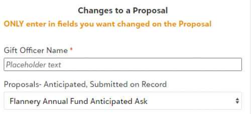

Hello all- I'm designing an adaptive card so fundraisers can submit a change to an existing proposal. For some reason in the response flow I want it to display the Proposal Name that was chosen by the Fundraiser but I'm getting “Undefined” in the results.
I have a choice set in the card set up which pulls in the Individual's Proposals. That works.
"type": "Input.ChoiceSet",
"choices": @{body('Select-_Proposals_on_Record')},
"placeholder": "Proposals on Record",
"id": "ProposalsRecord",
"label": "Proposals- Anticipated, Submitted on Record"
When the response comes in I have it under http request received like this:
"ProposalsRecord": {
"type": "string"
When I add the field to a String Variable the appears as “Undefined”.
I'm not sure what I'm missing here. In the form many of them only have one and you choose it like below
11c0a301f5bfcd1fd1a4db96d7b3af2e-huge-im
Thanks for any help!
-Carol

    Here is where I have the response as a string and I know it's the same ID as in my card. We're looking at ProposalsRecord.
    8ac4d71732353a6e1b6b1388184f1109-huge-im
    Here's where I am seeing “Undefined” when really I wanted the Proposal Name to appear. Below is the http request is received output.
    Which in my example would be Flannery Annual Fund Anticipated Ask. I've tried a few things, changing the card to be multiselect=true, style=expanded just to see if it was a card issue.
    a758cea3cb45c71ff37b632c44bb5199-huge-im

    It appears correctly on the form. For the Value I have item() maybe that's my problem?
  • @Carol Grant That most likely is your problem. From my experience I've found the Title value in the choice is what we see in the choice drop-down on the adaptive card but the Value value is what is passed back as the data element.
    Also, all of the values passed back from the response are read in string format. Since the item() looks to be an Object instead of string, it's likely causing that Undefined error
    I usually either make the Title and Value the exact same, OR I set the Value to be the ID of the record being selected in the choice drop down. That way you have that ID to work with in the next flow but users don't have to see the ID when viewing the drop-down choices.
    Give that a try and let us know if it still causes issues!
  • @Ashley Moose- That was exactly my problem! I made them the same and I can now see the value!! Thank you for making me look there, such a simple check I should have done. Now I realize they should be the same.
