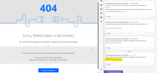

Here is a image of the error I get when I click the link in my Teams post:

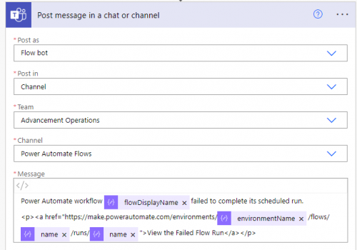

Here is a snapshot of my html code that I used in the flow:

Hi Alex,I copied the code into a text editor, and the following is what I have in the embedded in the post:
Power Automate workflow @{body('Parse_JSON_Current_Running_Work_Flow')?['content']?['tags']?['flowDisplayName']} failed to complete its scheduled run.
<p><a href="https://make.powerautomate.com/environments/@{body('Parse_JSON_Current_Running_Work_Flow')?['content']?['tags']?['environmentName']}/flows/@{body('Parse_JSON_Current_Running_Work_Flow')?['content']?['name']}/runs/@{body('Parse_JSON_Current_Running_Work_Flow')?['content']?['run']?['name']}">View the Failed Flow Run</a></p>------------------------
For some reason, the link comes out without any information from the variable fields. Here is the link that is being posted in Teams:

You are not pulling the right dynamic content.Your environmentName dynamic content is:
However, it should be:
@{body('Parse_JSON_Current_Running_Work_Flow')?['tags']?['environmentName']}
You are somehow telling power automate that the data you want to use is inside a “content” object of JSON, and then within it find “tags" and then find “environmentName”. Where in reality “content” is not a property.
The easiest thing to do is to “delete” the dynamic content, and select it from the dynamic content area. However, b/c there is 1 property that is the same name, it is hard to know which one you want to take and put it where on the URL. So here's something you can do:
Go to your Parse JSON Current Running Work Flow action, and in the Schema, put this in:
{"type":"object","properties":{"id":{"type":"string"},"name":{"type":"string","description":"base name"},"type":{"type":"string"},"location":{"type":"string"},"tags":{"type":"object","properties":{"flowDisplayName":{"type":"string"},"environmentName":{"type":"string"},"logicAppName":{"type":"string"},"environmentFlowSuspensionReason":{"type":"string"}}},"run":{"type":"object","properties":{"id":{"type":"string"},"name":{"type":"string","description":"name inside run"},"type":{"type":"string"}}}}}
The different is in the “red”, where I put “base name” as the description for the property of “name” in the base of the JSON object, and “name inside run” as description for the property of “name” inside the “run” object.
“x” out each of the dynamic content used in your send team message action and select from the dynamci content box the needed values.
Note the “name” property with the description of “base name” goes before /runs/
and
“name" property with the description of ”name inside run" goes after /runs/
