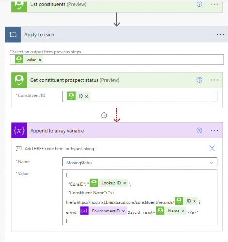

I need some assistance with the logic in a flow that finds the records in a list with a blank Prospect Status, and sends me an email. My questions are: Does this look correct, because when I create the HTML table in my email later, nothing shows; is it blank?
And I don't recall what the purpose of the red arrow above the Append step?
Thank you.
@Chris Zello
The red arrow pointing at your Append action means you've customized the Run After settings for that step. To verify, click the three dots in the upper right corner of the Append action and select “Configure run after”. There you'll be able to see which conditions will prompt this action to fire.It looks like the logic behind this flow is:
- Try to fetch a constituent prospect status for a specific constituent
- If no prospect status exists, that step will fail, which will cause the Append step to fire, adding the constituent to your array
That logic seems sound to me. If you have reason to believe that your flow isn't returning the constituents it should, the problem may be elsewhere.
