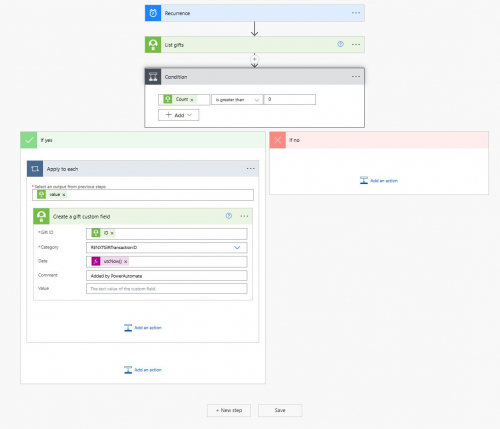

@Alex Wong Here is what it looks like before I add the Payments BBPS Transaction ID:

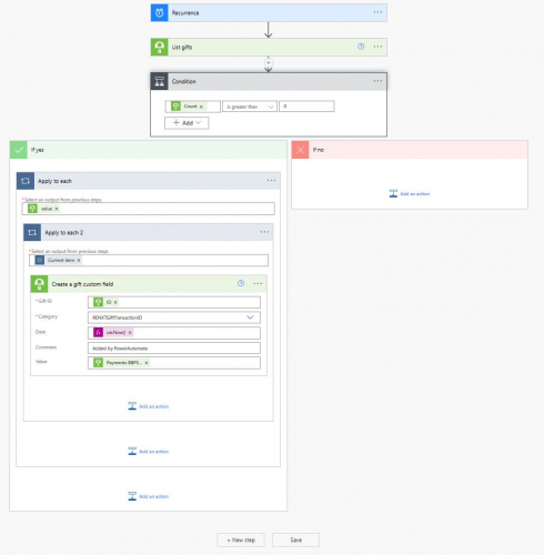

I consider this “normal.” Now, look what happens to the structure after I add that particular field:
I've tried changing out the “Current item” in the second Apply to Each to “value," but that yields PA to try to add the attribute at least twice in some sort of weird loop.

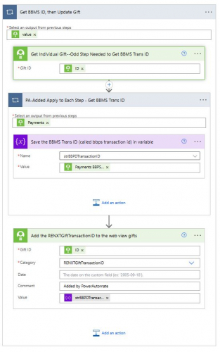

@Alex Wong I've found a solution, but I'm not sure why it works.
I used Get Gift after the Apply to Each step to successfully get the BBMS transaction ID (called bbps_transaction_id) in a variable. After that, I was able to update the transaction ID successfully.
Screenshot of revised flow below.

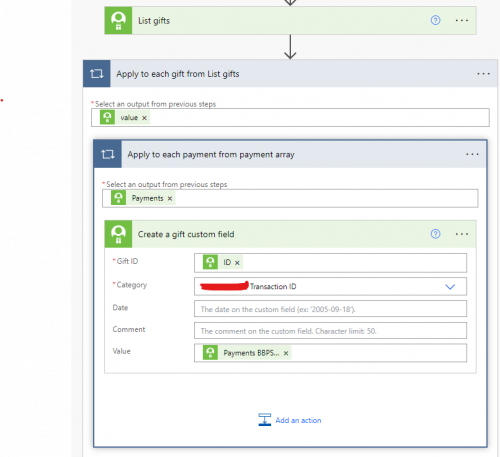

- because payments is an array, when you reference the bbps_transaction_id property, flow will put another Apply to each that loops through the payments array. This is where flow failed, and put the wrong dynamic content for you that caused the error you saw.
- To do this properly, you can simply add a Apply to each action yoursevles (don't let flow do it). Then in the * Select an output from previous steps, select the Payments dynamic content (the one that has desscription that say “The payments on the gifts”)

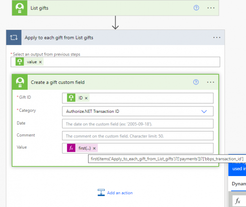

If you want to go a little more “clean”, KNOWING that there really is ONLY ONE payment object in the Payments dynamic content array, you can use the first() expression to get the first payment object in the array, and get the bbps_transaction_id off the first payment object.
@{first(items('Apply_to_each_gift_from_List_gifts')?['payments'])?['bbps_transaction_id']} 1 - After your List gifts action, you actually do not need to do a Condition action as the condition is simply if Count is greater than 0
