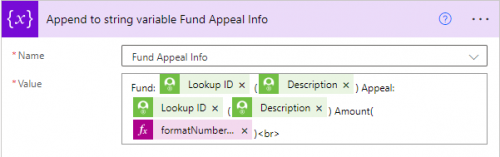

    First you need another variable (you can use a string variable) to store the fund and appeal info as it can have multiple. After the Get detailed donor info action, use the Get a fund and Get an appeal action on the Gift splits fund ID and Gift splits appeal ID dynamic content from the Get detailed gift info action. Flow will automatically put your action into an Apply to each action. If a gift has multiple fund and appeal, you may want to consider outputing the amount on the split per “set” of fund/appeal split too. Using the new variable, Append to the variable the fund/appeal/amount info following a HTML line break <br>.
    5bb88f354cbeb8f3c7c5acefba5fedaa-huge-im
    Fund: @{outputs('Get_a_fund')?['body/lookup_id']} (@{outputs('Get_a_fund')?['body/description']}) Appeal: @{outputs('Get_an_appeal')?['body/lookup_id']} (@{outputs('Get_a_fund')?['body/description']}) Amount(@{formatNumber(items('Apply_to_each_Gift_Split')?['amount/value'], 'C')})<br>

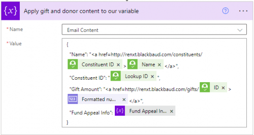

    Then in the Apply gift and donor content to our variable action, you can add the Fund Appeal Info string variable.

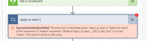

    Thanks, Alex! I am getting an error on the loop:
    49ce084fcdae2c0ec6fa99a6d1e18d73-huge-im
    The variable is initialized as a string, but should it be an array?

    from the look of the error, it also may be that you used the wrong splits fund/appeal id. You need to use from the get a gift detail action, not the listing of gift action.

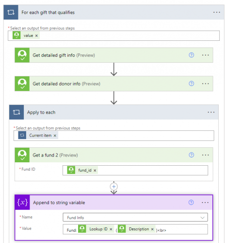

  • @Alex Wong
    After it checks for gifts in the list it does the following:
    fafa900f54ed05aa77e9fdfe6b9cbec0-huge-im
    0591bfa78cb9eb4ee4ac2b38aee3d5f1-huge-im
    61d7ac839c637fd2ec43361ab14b8ee0-huge-im
    43ba9c69bbc0f5d8d4aa3f98b7989ba3-huge-im
  • Alex Wong
    Alex Wong Community All-Star
    Ninth Anniversary Kudos 5 PowerUp Challenge #3 Gift Management Name Dropper
    @John Hazelwood

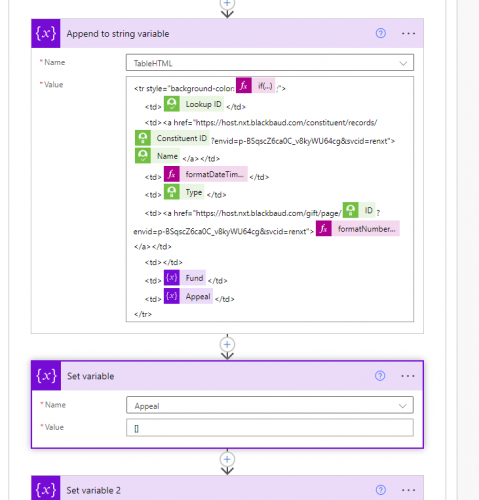

    First of all, if you plan on having separate column for Fund and Appeal, then having 2 separate variable for Fund and Appeal is OK, and they can be string or array, the diference will be in how you add to the array variable that will become the HTML table.
    You do not need 2 Apply to each (Apply to each 2 and Apply to each I see in the screenshot), you only need 1. The problem you are having is the “item” you are looking at in the apply to each mentioned: “Current item”, which is the “current gift record”. You need to target the current gift record's gift split array. So the easiest to do here is to delete both Apply to each 2 and Apply to each action, then add the Get an appeal action back, and in the Appeal ID field, look for the Gift Splits appeal ID dynamic content, which should be under your “gift list” dynamic content section (since you are not using “get a gift” action like the template has). WHEN you select the appeal ID, Flow will automatically put the apply to each action with the correct array selection in the “select an ouput from previous steps” field in the apply to each. then do the same to get a fund INSIDE the apply to each that was automatically created, if you select the gift split fund id correctly, it should NOT create another apply to each

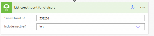

    Use the List constituent fundraisers action under the Blackbaud Constituent connector, provide the constituent's record's id.
    a1a4ad3ab09f0f03c26a2f8172196909-huge-im
    You will get an array (as there can be multiple fundraiser on a constiteuent), the array fundraiser_id will then have to use “get Constsituent” to get name of the fundraiser from its constituent record. You will need another variable as there can be multiple and then add to the HTML table array.

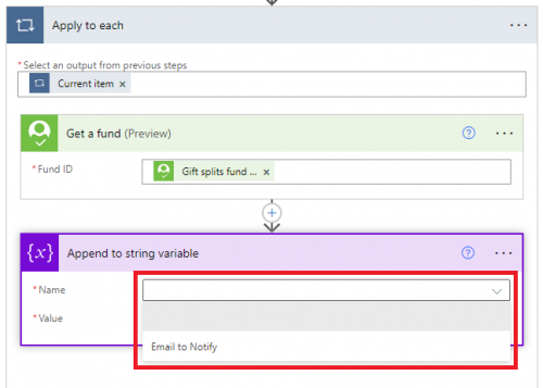

  • @Alex Wong Can you tell me what I have missed in setting up my flow that my only option here is a dropdown with “Email to Notify”?
    edb188d24b2ce0745769327f8d8072bb-huge-ex
    How do I get the variable to be named "Fund Info"? I am very new at learning about flows. Thanks for any help you can provide.

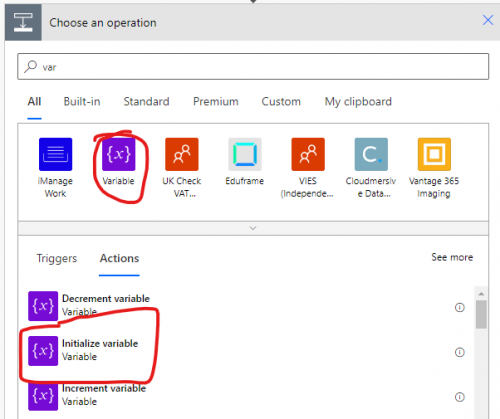

    All variable must be initialized first
    51051a7561436788d0fc6f0c6fd2d851-huge-im

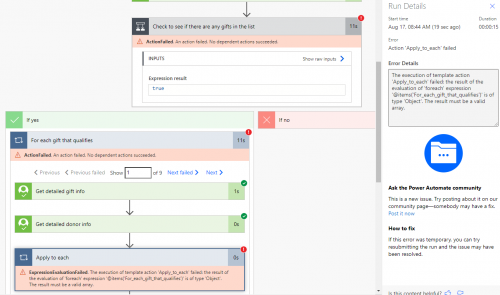

  • @Alex Wong Thank you. That worked but now I am getting this error. Do I need to change the “Select an output from previous steps” from “Current Item” to something else?
    The execution of template action 'Apply_to_each' failed: the result of the evaluation of 'foreach' expression '@items('For_each_gift_that_qualifies')' is of type 'Object'. The result must be a valid array.
  • Alex Wong
    @Tracey McKone
    the info you provide is too minimal to get any troubleshooting done. please provide screenshot of the action that caused the error and if within a apply to each loop, the apply to each action's screenshot too
  • @Alex Wong Here are some screen shots of the error and my flow. Thank you.
    5e93bd4bacc71aa226906c9a96b60a6a-huge-ex
    df20838baff82a2355deb1490b7f3044-huge-ex
  • Alex Wong
    @Tracey McKone
    The Apply to each is working on each gift splits in the gift split array property of a gift object. The “Current item” is definitely incorrect here. X the current item dynamic field. Search for “split” in the dynamic fields section's search and look for:

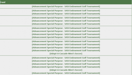

    Do you know why the email that is delivered would add the fund(s) from the previous cell above in addition to the fund for each gift.

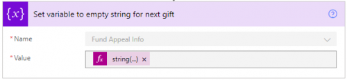

    b/c you never cleared the variable that store the fund info, so it just kept adding next gift's fund into it
    add an action as a LAST action before end of the Apply to each gift in list to set the variable empty string.
