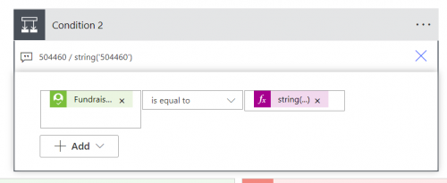

@Jana Birckbichler - Welcome to BB Community! The issue boils down to differing data types - how IDs are stored in RE NXT vs how PA interrupts numbers; the error codes received for this are notoriously unhelpful. Using a data type expression, you either need to convert the RE NXT ID into an Integer (Number) or convert the number PA is comparing against the ID into a String (Text).
Here's what I recommend: Using the String data type Expression convert the number to compare against the Fundraiser ID into text. It'll look like this –An additional recommendation - Rather than basing this off a Web View list, utilize the other fields available within the “List Gifts” action (particularly those under ‘Advanced Options’) to bring in only gifts added x or more days ago + other criteria. This will reduce the number of conditionals and apply to each's needed to run your flow, enabling it be more efficient.

Second Austen's recommendation to use List Gift action to filter, will make your flow cleaner and less “layer”PA does some assumption when it is conditioning of dynamic content and literals. So the best thing to do is to not let it does the assumption. Austen recommendation ensure you are comparing apple to apple.
Though my question is your flow's logic and what you trying to do, you have specifically a fundraiser's id typed in, is it your intention to only have this flow run for 1 fundraiser?
If not, assuming you are trying to create a constituent action for any fundraiser that is listed as the gift's fundraiser, then you don't even need “Condition 2” action. You can simply just go ahead and create the constituent action with the dynamic content of Fundraiser ID on the gift.

@Austen Brown Thanks again Austen. It worked perfectly. Thank you for helping me to learn about this.
