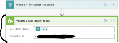

Ok, I did not realize you were not with Blackbaud any longer, but I thank you for responding. I'm not really sure at this point what I want to accomplish with the Sky Add-Ins connector and Power Automate. I am just starting to get my hands on it and see what I can do. I guess a most simple question is should I be able to register a Blackbaud hosted Staging environment as a Sky Application in my Sky developer account and use the Sky Add-Ins connector to successfuly utilize the “validate a user identity token” action and then use the HTTP request from the connector to call the Sky APIs?0 -

Hi Glen. Thank you. We are hosted by Blackbaud and our Staging environment is on BBID, but I cannot get past the “Validate a user identity token” step when using the Sky Add-Ins connector with Power Automate. If I understand correctly, it seems like that should work when using the Application ID of the app I registered using our Staging CRM link. I'm not sure what I'm missing or maybe I am not understanding. As mentioned, I am just beginning to play around with this. I was excited to be able to embed a Custom Component using the URL of another flow, so just digging into other capabilities.0 -

Apologies for the back and forth. I am not being very clear. Let me try to restate. I was able to embed a Custom Component using the URL of a power automate flow. It was actually your Weather (All In One) post that helped me be able to do that. What I am now trying to do is something completely separate just as a learning exercise, trying to use the “Create an Adaptive Card Sky Add-In template”. I registered my Staging link as a Sky Application, put my Application ID in the Validate token action, followed the instructions for adding the Add-In as a Tile to my application (screenshot) while url-encoding the CardServiceURL. I think I expected it to show up as a Constituent Tile in CRM.0 -

The problem is that the CRM webshell isn't (currently) a SKY Add-in "host" so it won't be able to produce a user identity token to send to your flow to validate (along with any "context" object).

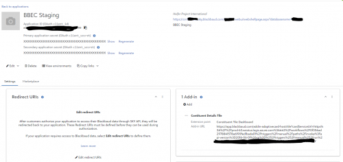

Thank you both for your help. I am understanding more now. I hope to not take up much more of your time. I think I am close to having my adaptive card show using the Page Host SPA.
I was on the right track based on the steps Ben provided, but I had missed a couple of things. I believe I have now followed all of the steps correctly. When I go to the Page Host SPA url, I see an omnibar with the 3 bars (dropdown menu) on the left and my user logo on the right; however, my adaptive card is not displaying. I just show a blank page. I am just using the “hello world” adaptive card from the walkthrough examples. I don't see that my adaptive card Power Automate flow was activated (not sure if I should, but I would think so). I am going to try to figure out what I'm missing, but wanted to follow up with the status and see if I might be missing something obvious. Again, thank you both.
@Kevin Hamling Following up, were you able to get this working? A few things to check:
- Make sure your SKY application is connected to your Blackbaud environment (via the Marketplace → Manage page)
- Make sure your Page add-in has an appropriate “Name” (this is what the Page Host SPA will use to find the URL to use for the embedded iframe that will render your add-in)
- Make sure you've properly encoded your flow's URL when you specify it as the cardServiceUrl parameter when defining your Page add-in.
When you access the Page Host SPA, it checks to see if your app (as specified in the route of the URL) is connected to your Blackbaud environment, and that your app has an add-in with the Name that you specified (also in the route of the URL).
If you open your browser's debugger, do you see any error messages?
