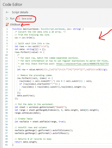

- ONE TIME SETUP: Need the Excel Script saved to your MS user account

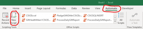

- While you have the excel file open from above step, click on the Automate menu at the top and then click on New Script (see image 1 below)
- A Code Editor would appear on the right-panel of Excel, which you can highlight to delete the default code that's there, give it a name (I just name it CSV2Excel) and copy and paste below code into the code editor body area and click Save script (see image 2 below)

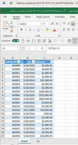

This is the look of the excel file after the flow is done:

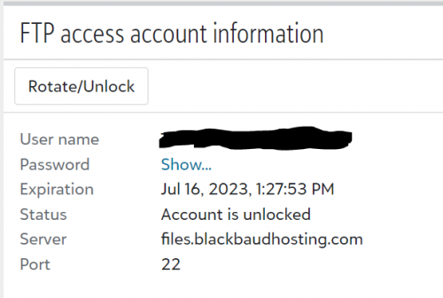

can you screenshot what the FTP access account information tile in the Database options? make sure to cross out the username and password. or you can paste just the server url0 -
@Lindsey Copeland

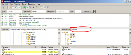

yup, definitely blackbaud hosting, not azure.what you can do is to download and use a FTP client, such as FileZilla, after logging in, you will be able to “drill down” to the folder path where you want Power Automate to monitor. Then you just have to copy the path from FileZilla

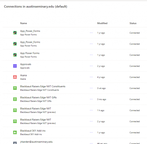

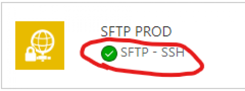

Can't get the Import button to become active. Under related resources, BB sFTP-New/SFTP - SSH Connection, option is to select during import but when I click on that, I just have the option to Create New and when I click on that I just get a list of connections. What do I pick there?0 -
@JR Barden
If you never established a SFTP connection to your Blackbaud environment's SFTP site, then you will have to first do that and then can select it in the import process.the connection to use is SFTP - SSH

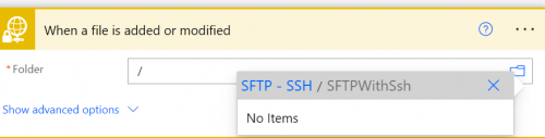

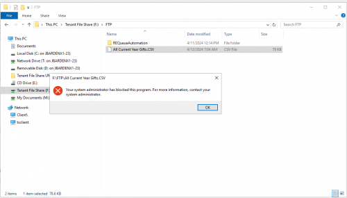

@Alex Wong Well shoot! I got it to work once, but then it stopped and won't let me open the files in the FTP folder. So the flow can't move them from the FTP site to sharepoint. :-(
@JR Barden
the screenshot you show is a “remote” file explorer that you open when click on Hosted File, you will NOT be able to open ANY file using any program when in the “remote” file explorer. So the error message is not related to the flow.If you want to manually move file from remote file explorer to sharepoint, you will need to create onedrive shortcut to the sharepoint location where it becomes available on your “local file explorer” first. Then from there in the remote file explorer, you can “move” or copy the csv file to the network mapped C:\\ of your local drive.
However, what I explained above is simply trying to get file manually. Has nothing to do with the flow that automates the csv file to sharepoint. So i'm not sure what you mean by “got it to work once”.
