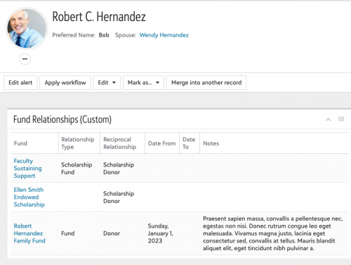

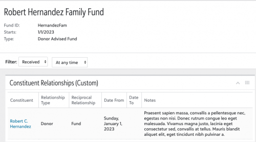

Sharing my Power Automate template: RENXT Constituent/Fund Relationship Tiles
- Description: This “All in One” flow renders custom tiles for Fund Relationships on a Constituent Record and Constituent Relationships on a Fund Record. The links open a fly-out to the corresponding record.
- Required connections: Raiser's Edge NXT Fundraising and SKY Add-Ins

@Glen Hutson This is fantastic! It's precisely one of the things I was looking to do with Power Automate. I was able to get it set-up on our test database very quickly and I'm pretty new to the platform.
One thing I found is that when I set it up as instructed with “&recordType=fund” added to the Constituent Tile Dashboard Extenstion Point URL and “&recordType=constituent” added to the
Fund Tile Dashboard URL. The tile wouldn't return anything. I flipped the the pieces added to the URLs and it started working.
(I think the instructions have the extension point names flipped)0 -
