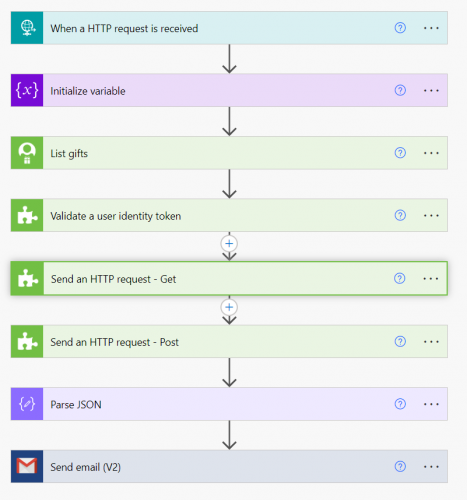

I could use some guidance…I am trying to do this in order to run a list of the last pledge installments. I seem to be missing a step…as the flow states there is no starting point? Can you help…?0 -

Unfortunately, it is not easy to do this only in Power Automate flow. Since the Gift v2 to get installment and payment is per pledge, you will have to get ALL pledge's installment and payment to do what you want to do. At least you will need to do all pledge where balance is not 0.Below is what you “can” do in 1 flow, but I strongly recommend handling this with installment and payment data already stored somewhere (sharepoint list/excel/csv, data warehouse, etc) and query from there.
So first step is to know how many you are dealing with. Run a gift list with gift type = pledge. Then filter (using Filter action) the returned gift array on balance property greater than 0. see how many non-paid off pledge you have. (if pledge is paid off, then the pledge is not needed in your processing).
then from this filter action, you will get an array of pledge that's not paid off, you will need to use Apply to Each on each pledge, and get installment and payment information from the pledges. you can then use “last(installment_array) and the month of this being next month. you will need to consider if payment is already applied to this installment either fully or partially paying the installment off (as pledge balance not 0 does not ”exactly" mean last installment is unpaid)
