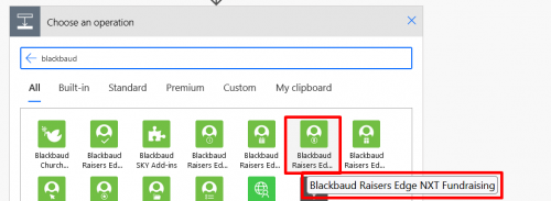

First, the Fundraising connector is referring to this:
You've likely just been working with the Constituents and/or Revenue connectors. For reference, you can see the full list of connectors and the details included in each on Microsoft's website: https://learn.microsoft.com/en-us/connectors/

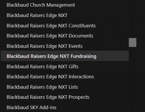

And all of the Blackbaud connectors include:

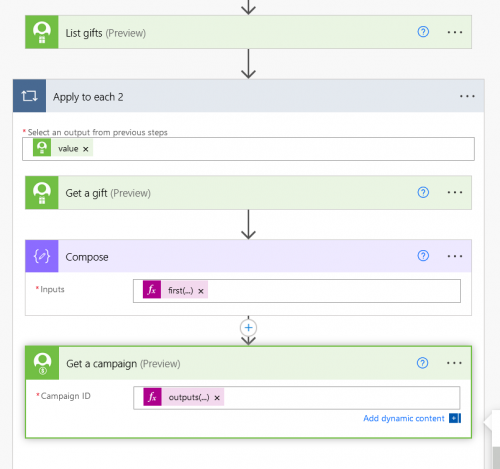

Now specific to your question, I imagine your flow first has a List gifts action to bring in all of the gifts you need to acknowledge, and then a Get a gift action to get the specific details for each gift. After the Get a gift action, you can then add a Compose action with an expression of first(outputs('Get_a_gift')?['body/gift_splits']). Then add the Get a campaign action from the Fundraising connector and pull from the Compose action with an expression of outputs('Compose')?['campaign_id'].The output of the Get a campaign action would then include the details like Campaign description.
And that should be it!

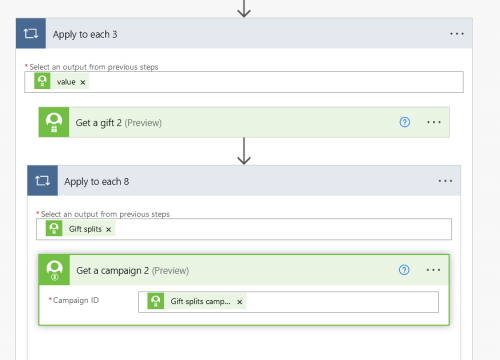

I do want to note what it would look like if you called the Get a campaign action without using the middle Compose action. If I pulled the Gift Splits Campaign ID directly from the Get a gift output, Power Automate would automatically add the Get a campaign action inside another Apply to each action, like this:
You can still get to the end result having this Apply to each included, but it becomes a bit more complicated as you need to untangle the results from that Apply to each step. There are a couple different ways you can do that, but as long as your organization does not have split gifts, you can keep with the simpler option of using the first() expression.
